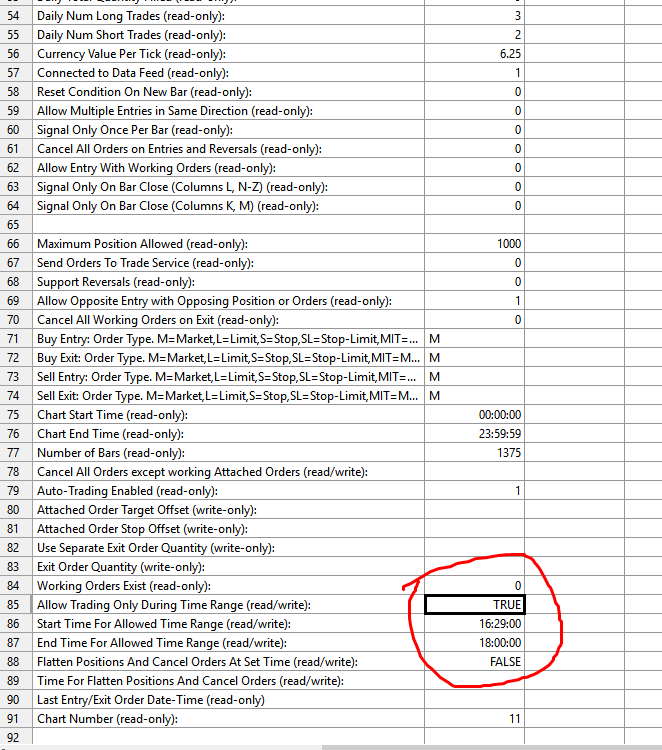

This is controlled through the following three Spreadsheet Study Sheet inputs:
Spreadsheet Systems, Alerts and Automated Trading: Allow Trading Only During Time Range (read/write) [v1:J85, v2:J94]

can i just use this in spreedsheet without any coding??

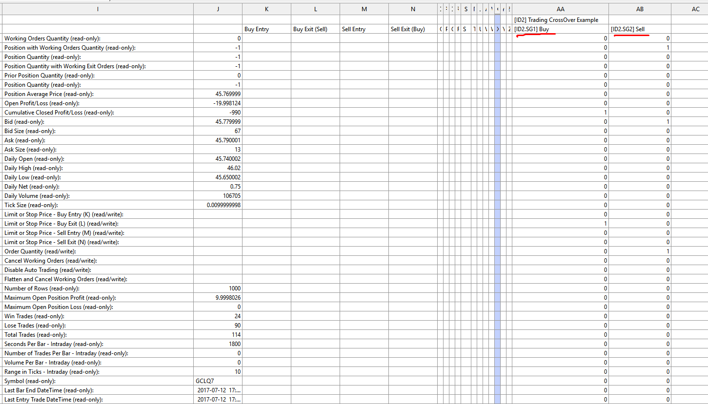

Donz - Posts: 17
Here is the logic for entry from my spreedsheet study
if ID2.SG1=1 , then buy signal
If ID.SG2=1 , then sell signal
ONLY specific time at 19:00:00 until 20:00:00
hope can help
Date Time Of Last Edit: 2017-07-12 09:06:17
