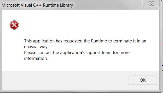

I have received a runtime error while backtesting my ACSIL code. Please see attached screenshot of error. As per the screenshot, it asked me to contact you for further information. And Sierra Charts crashed afterwards due to this error.
imageRuntimeError_June292017.JPG / V - Attached On 2017-06-30 05:51:01 UTC - Size: 29.67 KB - 542 views

The problem is this is almost 99 percent likely to be triggered by a problem in your own source code.
The general procedure is to run Sierra Chart in Safe Mode as explained in help topic 17:
Sierra Chart Unexpectedly Shutting Down | Memory Errors | Unusual Software Problems | Exception Errors | Freezing of User Interface
And if you do not encounter the problem, that means the problem is in your custom DLL study.
Try one of the Sierra Chart trading systems and see if you have the same problem. You definitely should not.

I suspect so too but I thought I check with you just to be sure and the only thing that I can think of is for some very strange reason, my two integer variables Trade_PosL and Trade_PosS that I set up as persist variables that I mentioned in this ticket Persist Variables still shows up with value 1086121984 even after I have changed them to be just regular variables NOT persist variables of int data types as part of my troubleshooting attempts. I suspect it's those two integers that somehow overwhelmed the memory allocation and generated this error. Would you know what this value 1086121984 is? If you can let me know, it would give me a clue as to where I can look.

What this sounds like is there is a memory corruption occurring in your custom trading study which is leading to various issues.
No, this would not make sense.
