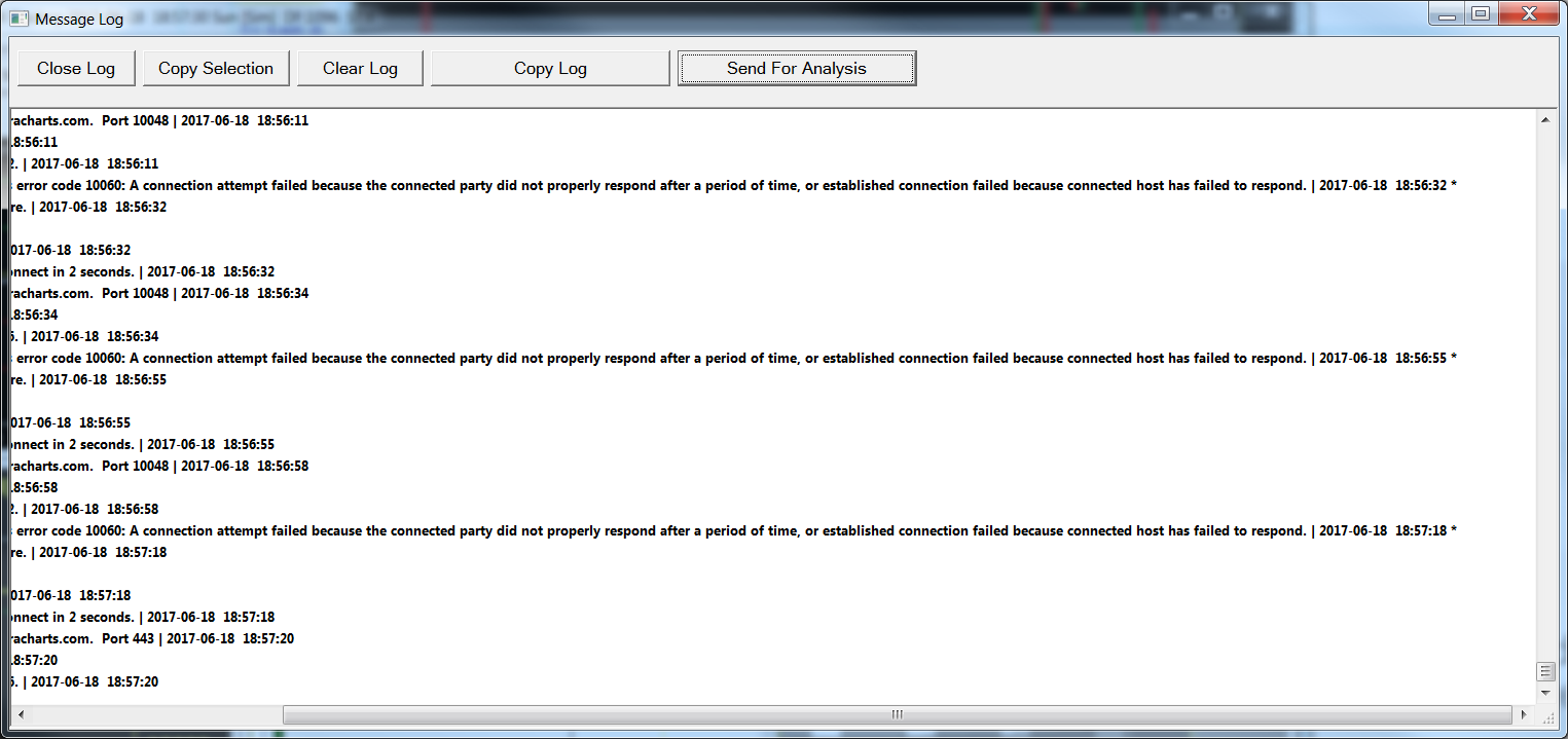

I'm sending the log because I don't know what it means, but something keeps kicking me out of connection to CQG feed.
imageLog.png / V - Attached On 2017-06-18 23:55:40 UTC - Size: 131.8 KB - 369 views

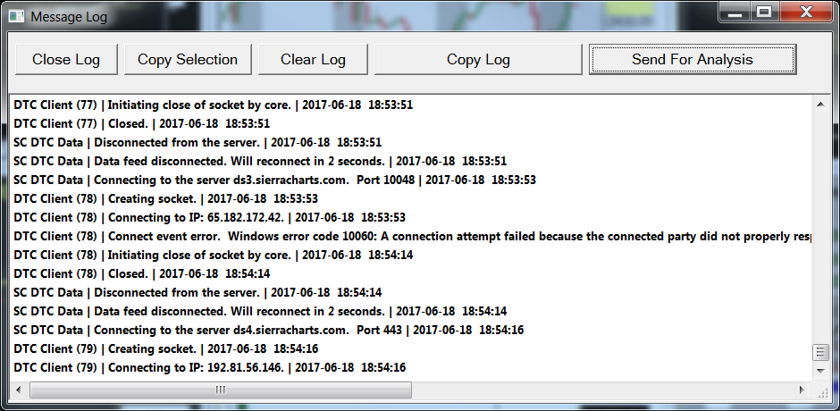

TekDiver609 - Posts: 20
File attached
imageLog2.png / V - Attached On 2017-06-18 23:58:20 UTC - Size: 170.12 KB - 373 views
[2017-06-19 00:01:36]
Usermb - Posts: 126
I also have the exact same problem:
DTC Client (20) | Connect event error. Windows error code 10060: A connection attempt failed because the connected party did not properly respond after a period of time, or established connection failed because connected host has failed to respond. | 2017-06-19 01:58:21 *
DTC Client (20) | Initiating close of socket by core. | 2017-06-19 01:58:21
DTC Client (20) | Closed. | 2017-06-19 01:58:21
SC DTC Data | Disconnected from the server. | 2017-06-19 01:58:21
SC DTC Data | Data feed disconnected. Will reconnect in 2 seconds. | 2017-06-19 01:58:21
SC DTC Data | Connecting to the server ds4.sierracharts.com. Port 443 | 2017-06-19 01:58:23
DTC Client (34) | Creating socket. | 2017-06-19 01:58:23
DTC Client (34) | Connecting to IP: 192.81.56.146. | 2017-06-19 01:58:23
DTC Client (34) | Connect event error. Windows error code 10060: A connection attempt failed because the connected party did not properly respond after a period of time, or established connection failed because connected host has failed to respond. | 2017-06-19 01:58:44 *
DTC Client (34) | Initiating close of socket by core. | 2017-06-19 01:58:44
DTC Client (34) | Closed. | 2017-06-19 01:58:44
SC DTC Data | Disconnected from the server. | 2017-06-19 01:58:44
SC DTC Data | Data feed disconnected. Will reconnect in 2 seconds. | 2017-06-19 01:58:44
SC DTC Data | Connecting to the server ds3.sierracharts.com. Port 10048 | 2017-06-19 01:58:46
DTC Client (35) | Creating socket. | 2017-06-19 01:58:46
DTC Client (35) | Connecting to IP: 65.182.172.42. | 2017-06-19 01:58:46
HTTP connection to ds01.ddfplus.com:80 (7) | Socket gracefully closed by remote side. | 2017-06-19 01:58:47
HTTP connection to ds01.ddfplus.com:80 (7) | Received socket Close event | 2017-06-19 01:58:47
HTTP connection to ds01.ddfplus.com:80 (7) | Initiating close of socket by core. | 2017-06-19 01:58:47
HTTP connection to ds01.ddfplus.com:80 (7) | Graceful close received or receive error. Shutdown complete. Closing socket now. | 2017-06-19 01:58:47
HTTP connection to ds01.ddfplus.com:80 (7) | Closed. | 2017-06-19 01:58:47
DTC Client (35) | Connect event error. Windows error code 10060: A connection attempt failed because the connected party did not properly respond after a period of time, or established connection failed because connected host has failed to respond. | 2017-06-19 01:59:07 *
DTC Client (35) | Initiating close of socket by core. | 2017-06-19 01:59:07
DTC Client (35) | Closed. | 2017-06-19 01:59:07
SC DTC Data | Disconnected from the server. | 2017-06-19 01:59:07
SC DTC Data | Data feed disconnected. Will reconnect in 2 seconds. | 2017-06-19 01:59:07
SC DTC Data | Connecting to the server ds4.sierracharts.com. Port 10048 | 2017-06-19 01:59:09
DTC Client (36) | Creating socket. | 2017-06-19 01:59:09
DTC Client (36) | Connecting to IP: 192.81.56.146. | 2017-06-19 01:59:09
DTC Client (36) | Connect event error. Windows error code 10060: A connection attempt failed because the connected party did not properly respond after a period of time, or established connection failed because connected host has failed to respond. | 2017-06-19 01:59:30 *
DTC Client (36) | Initiating close of socket by core. | 2017-06-19 01:59:30
DTC Client (36) | Closed. | 2017-06-19 01:59:30
SC DTC Data | Disconnected from the server. | 2017-06-19 01:59:30
SC DTC Data | Data feed disconnected. Will reconnect in 2 seconds. | 2017-06-19 01:59:30
SC DTC Data | Connecting to the server ds3.sierracharts.com. Port 10048 | 2017-06-19 01:59:32
DTC Client (38) | Creating socket. | 2017-06-19 01:59:32
DTC Client (38) | Connecting to IP: 65.182.172.42. | 2017-06-19 01:59:32
DTC Client (38) | Connect event error. Windows error code 10060: A connection attempt failed because the connected party did not properly respond after a period of time, or established connection failed because connected host has failed to respond. | 2017-06-19 01:59:53 *
DTC Client (38) | Initiating close of socket by core. | 2017-06-19 01:59:53
DTC Client (38) | Closed. | 2017-06-19 01:59:53
SC DTC Data | Disconnected from the server. | 2017-06-19 01:59:53
SC DTC Data | Data feed disconnected. Will reconnect in 2 seconds. | 2017-06-19 01:59:53
SC DTC Data | Connecting to the server ds4.sierracharts.com. Port 10048 | 2017-06-19 01:59:55
DTC Client (39) | Creating socket. | 2017-06-19 01:59:55
DTC Client (39) | Connecting to IP: 192.81.56.146. | 2017-06-19 01:59:55
DTC Client (39) | Connect event error. Windows error code 10060: A connection attempt failed because the connected party did not properly respond after a period of time, or established connection failed because connected host has failed to respond. | 2017-06-19 02:00:16 *
DTC Client (39) | Initiating close of socket by core. | 2017-06-19 02:00:16
DTC Client (39) | Closed. | 2017-06-19 02:00:16
SC DTC Data | Disconnected from the server. | 2017-06-19 02:00:16
SC DTC Data | Data feed disconnected. Will reconnect in 2 seconds. | 2017-06-19 02:00:16
SC DTC Data | Connecting to the server ds3.sierracharts.com. Port 10048 | 2017-06-19 02:00:18
DTC Client (40) | Creating socket. | 2017-06-19 02:00:18
DTC Client (40) | Connecting to IP: 65.182.172.42. | 2017-06-19 02:00:18
DTC Client (40) | Connect event error. Windows error code 10060: A connection attempt failed because the connected party did not properly respond after a period of time, or established connection failed because connected host has failed to respond. | 2017-06-19 02:00:39 *
DTC Client (40) | Initiating close of socket by core. | 2017-06-19 02:00:39
DTC Client (40) | Closed. | 2017-06-19 02:00:39
SC DTC Data | Disconnected from the server. | 2017-06-19 02:00:39
SC DTC Data | Data feed disconnected. Will reconnect in 2 seconds. | 2017-06-19 02:00:39

There was a problem with the Sierra Chart provided data feeds which includes Forex/CFD, market statistics and crypto currency data. This is now resolved.
This is definitely not true. If the Sierra Chart server has a problem it has zero effect on the connection to CQG.
Same issue with Transact, everything works fine with Rithmic though
The connection to TransAct was not affected, only the Forex/CFD, market statistics and crypto currency data.
Date Time Of Last Edit: 2017-06-19 01:55:43
[2017-06-19 01:59:48]
Thanks Sierra, issue solved

In regards to post #14, start a new Support Request.
We see you are using CQG. We have no idea what the problem is in your case. Most likely it is totally unrelated. Actually it would have to be.
And also provide a copy of the Message Log.
We are locking this thread now.
