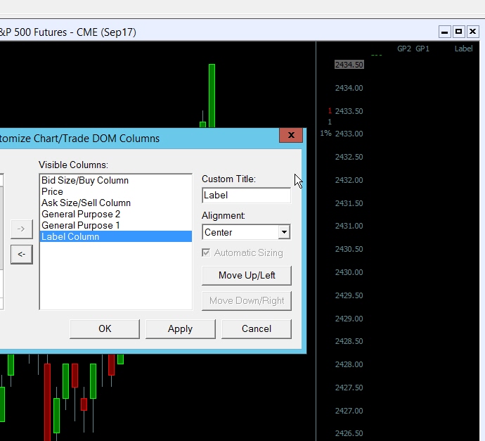

ejtrader - Posts: 689
SC Team - Noticed you have introduced General Purpose Chart DOM columns(Thank you) but are set to "Auto Resize" by default and no option to change them.
Wondering if it is possible to change the width of the column by other means(ACSIL/Chart settings etc).
Edit - Never mind - Found a work around - I could control it by Padding the label as needed.
thanks

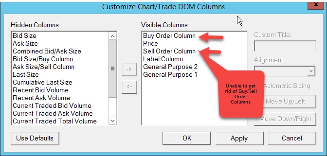

When the Chart market data columns are configured in certain way - the width can not be adjusted using "drag" mode as described in the documentation.
Attached is the sample chartbook (no studies) which demonstrate the issue.
Tried to get rid all possible columns except the general purpose columns. That's when you would notice this issue. Would it be possible to remove buy order / sell order columns and just have the general purpose columns with adjustable width by any means?
thanks

[2017-06-27 17:28:30]
Regarding feature requests, we cannot accept those now and it would be years before we could look at them.
We will look into the described issue in post #4.
Date Time Of Last Edit: 2017-06-27 17:28:41
[2017-06-27 18:02:21]
Actually Yes. You just need to use Trade >>Show Market Data Columns and do not enable the Chart DOM.
But we need to add support to adjust the columns in this case.
Date Time Of Last Edit: 2017-06-27 18:03:11
