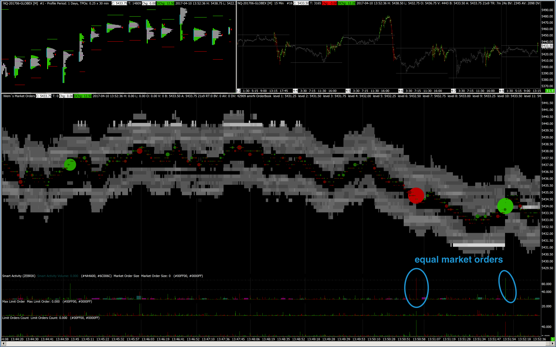

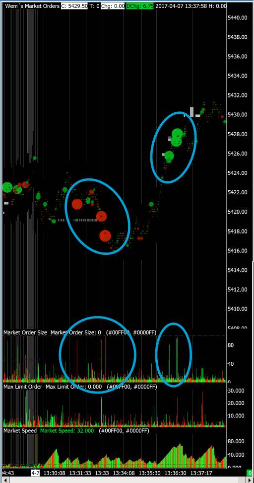

User64410 - Posts: 14
I have done this a year ago already using BID_ASK_TRADE_SYNC data, and result is quite good:
imageSnímek obrazovky 2017-04-10 v 15.52.35 (kopie).png / V - Attached On 2017-06-17 14:23:43 UTC - Size: 225.21 KB - 628 views
imageSnímek obrazovky 2017-04-07 v 15.37.57 (kopie).png / V - Attached On 2017-06-17 14:25:33 UTC - Size: 96.75 KB - 556 views
