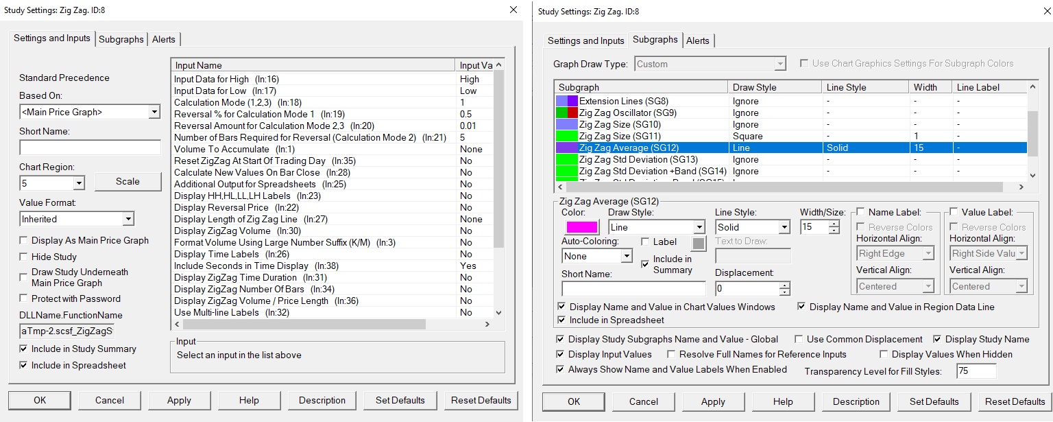

Thank you for updated CPP
I have compiled your cpp into dll, added it as a study, but unfortunately i don't understand how to get it to draw an average zig zag length with it. In study parameters there doesn't seem to be a setting "Draw average=yes" or something; in Subgraphs i see there is a "ZigZag average (SG12)" but it also seems to do nothing. Could you please advice how to use this study?
Many thanks

User431178 - Posts: 910
Example chartbook attached.
a) Use Study Subgraph Reference (or similar) to display the value from the Zig Zag study in a different chart region.
b) Add zig zag study to region other than main price graph, set all subgraphs except Zig Zag Average to Ignore.
Also, you need to set the Number of Zig Zags used for Statistics to a sensible number.
attachmentZigZagAverage.Cht - Attached On 2022-07-30 09:25:59 UTC - Size: 6.77 KB - 472 views

WyckoffSleuth - Posts: 36
Thank you very much - got it to work, looks great!
