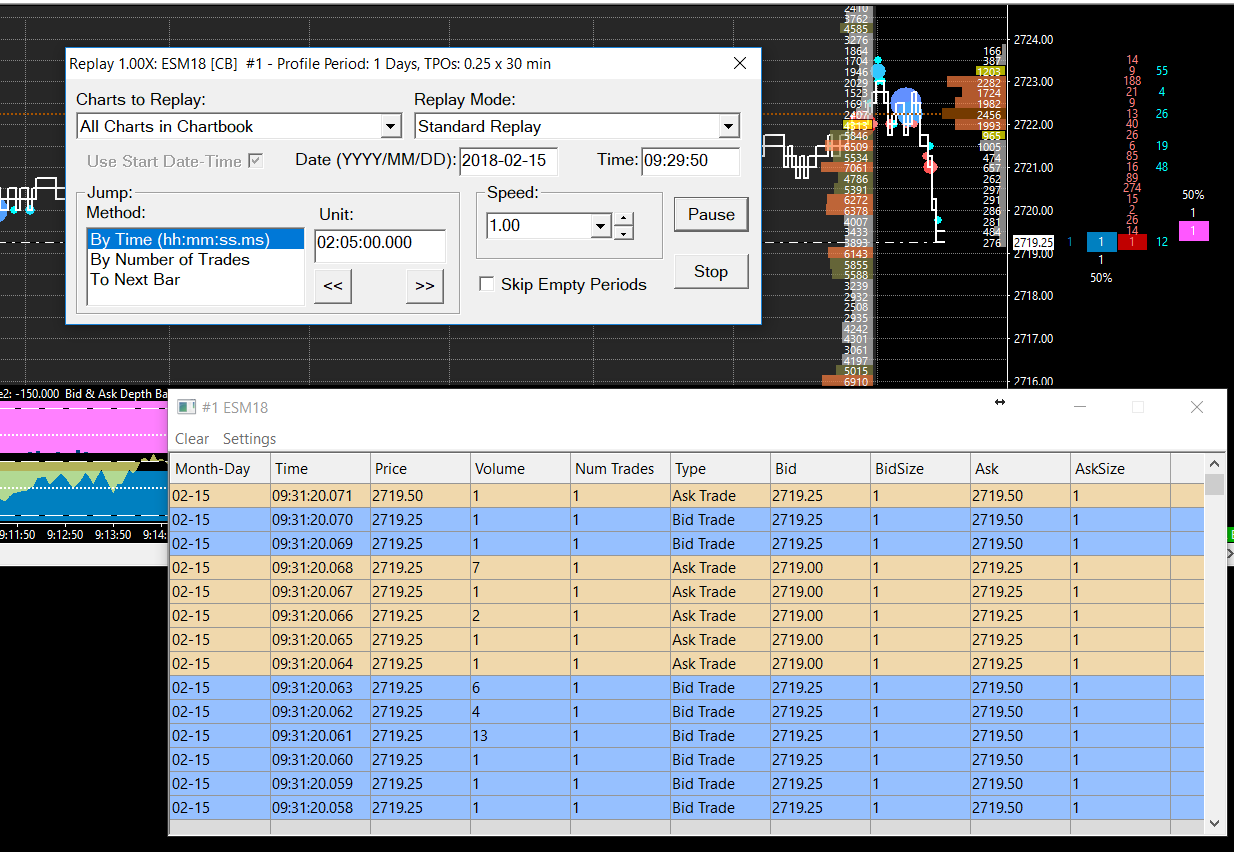

[2018-03-10 14:06:02]
whats1thingnow - Posts: 418
Go to the chart an open the market depth window with File >> Open Market Depth Window and replay it. As long as there is depth data for the particular Date-Time you are replaying you should see it.
please see screenshot
- the replay is set to feb 15th, and i use "start date time"
- market depth window does show market depth data (in the "month-day" column it is showing "02-15")
- however, the Market Depth Historical Graph is not showing anything, nor is the dom showing the depth
Make sure you are on the current version.
i just downloaded again and now i'm on 1716
thank you for helping with this
image2018-03-10_0557.png / V - Attached On 2018-03-10 14:05:10 UTC - Size: 107.77 KB - 606 views
[2018-03-10 19:44:43]
We cannot help you, if you are not even following our instructions. Look closely at what we said and look closely at what you are showing.
Date Time Of Last Edit: 2018-03-10 20:02:37
[2018-03-10 20:02:03]
When the replay is started, and there is market depth data available for a particular day you will see this in the Window >> Message Log:
Loaded depth data records for UDH18 2018-02-28 from 2018-02-27 19:00:04 to 2018-02-27 20:56:35. | 2018-03-10 15:01:17
If you are not seeing messages like this, the depth data is not even being loaded.
