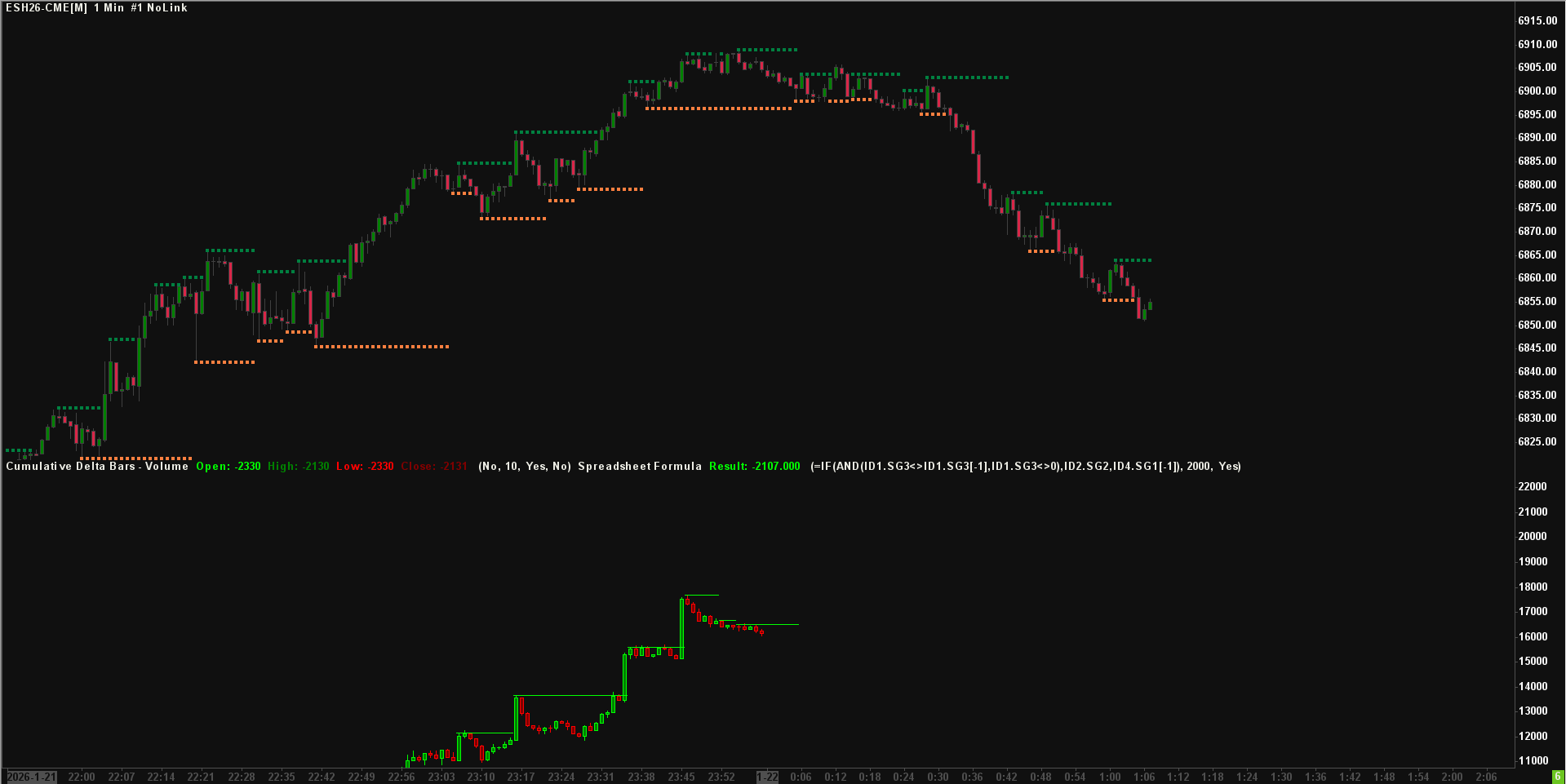

[2026-01-21 04:28:58]
jethrogou - Posts: 56
Whenever I load back in sierra or enter replay mode, my spreadsheets doesn't get recalculated. Is there a way to automatically recalculate every time I replay or open back up the charts?
Date Time Of Last Edit: 2026-01-21 10:39:19
imageScreenshot 2026-01-21 122819.png / V - Attached On 2026-01-21 04:28:36 UTC - Size: 94.05 KB - 195 views
[2026-01-21 15:43:09]
The spreadsheet absolutely should be recalculating with a replay and when the chart is opened. What are you seeing where this is not occurring?
Are you using a Spreadsheet Study, or one of the standard spreadsheets created by selecting "File >> New Spreadsheet"?

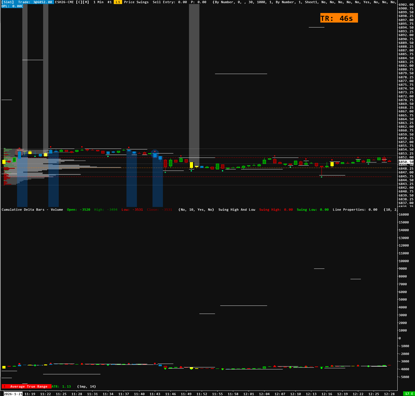

[2026-01-21 17:09:17]
There must be a setting I can change to fix this, because I tried using my reference scss from sawtooth and it works fine during replay. No manual recal needed on saw tooths chartbook.
Edit: There seems to be no difference between my scss and sawtooth's scss aside from the value format. There must be something I can change within my chart settings.
Date Time Of Last Edit: 2026-01-21 17:27:06
imageScreenshot 2026-01-22 010732.png / V - Attached On 2026-01-21 17:08:32 UTC - Size: 57.09 KB - 197 views
imageScreenshot 2026-01-21 122819.png / V - Attached On 2026-01-21 17:10:31 UTC - Size: 94.05 KB - 166 views
[2026-01-21 18:47:39]
Are you trying to change a value for an older bar based on information from a recent bar? This is the only situation where the way the spreadsheet calculates would make any difference.
There are no settings to change how the calculations work. The recent rows are only calculated in order to cut down on overhead from the study.
Also, the way the spreadsheet calculates in replay is going to be the same as real-time. So if you are not having a problem in real-time, then there should not be an issue in replay.
There must be something about your setup that is causing the issue you are stating.
[2026-01-21 19:11:40]
I'm not sure. I'll explain how my spreadsheet works and maybe you can find the issue.
My Spreadsheet references:
- CVD Study
- Swing high/low (based on CVD)
- Price high/low
My Spreadsheet function:
- Converts CVD swing highs/lows to price swing highs/lows
- Draws line on swing high/low on price levels based on CVD swings
- Detects divergences of the highs/lows of both CVD and Price.
I think none of these functions are trying to change previous bars but instead are only gathering data from them. The attached files are from sawtooth's free access scss. The functions I replicated is the line plotting of the swing highs/lows which shouldn't cause any issue based on previous tests. The functions I added were the conversion of current values and divergence detector.
Edit: Each functions has its own spreadsheet so I remove each one to find the issue, but it seems like all of it has the same issue. Maybe it has to do with the conversion?
Date Time Of Last Edit: 2026-01-21 19:16:46
