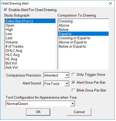

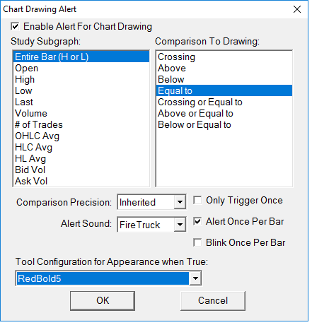

Horizontal line alert = play a sound and set the appearance to TC2.
When it is triggered, my sound plays and the line changes to TC2. Problem is when I reset the line back to TC1 on the toolbar, the alert setting also changes it back to TC1 and the next time it is triggered it doesnt trigger TC2 appearance.
[2017-05-19 15:45:40]
Yes this will be the case.
Is the Tool Configuration 1 for the Horizontal Line tool set to do this?
[2017-05-19 16:34:45]
grantx - Posts: 244
Im not sure what you mean. The default for horizontal lines is set to TC1 (Green,size 1).
Ween the alert is triggered the line stays in alert appearance (red,bold,size 5)
I then go and reset the line to TC1 because I have seen the alert and want it reset for next time the line is touched.
But, next time the alert is triggered, it doesn't change to TC2.
See attached. #1 is prior to alert and #2 is after the alert.
image1.png / V - Attached On 2017-05-19 16:34:14 UTC - Size: 13.95 KB - 425 views
image2.png / V - Attached On 2017-05-19 16:34:18 UTC - Size: 13.9 KB - 453 views
