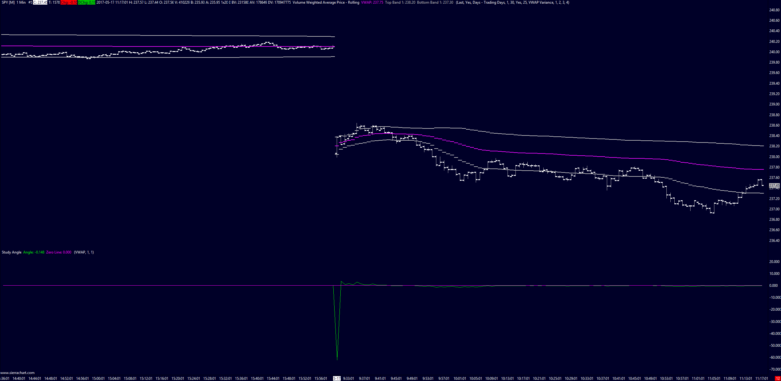

[2017-05-17 21:18:03]
Neo - Posts: 198
Currently, the Study Angle continues on from the last trading day. So when a gap is present( which is most of the time), it adds a large skew to the start of the current day.
Is it possible to add an input to reset at the start of a new session?

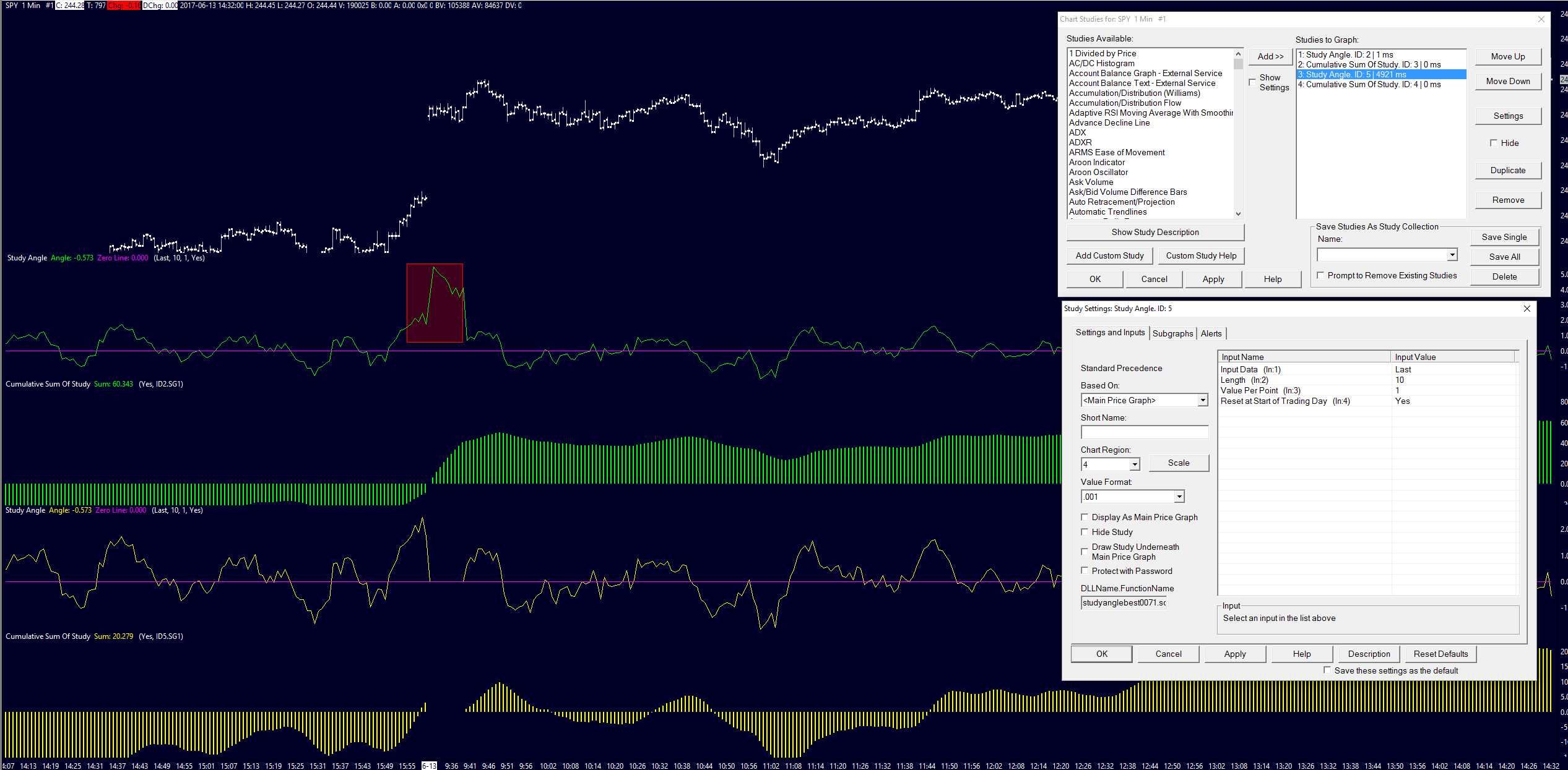

My trouble with your implementation is that it only skips the calculation at the start of the session, and will still look back at data from the previous day. So a gap day creates a big skew, especially when looking at the cumulative result( See image below- Green vs Yellow( my version)
I have taken your advice and implemented the changes myself. The only trouble is the performance is poor. Could you make any comments on how I could improve this?

imagestudyanglereset.png / V - Attached On 2017-06-14 08:11:29 UTC - Size: 119.59 KB - 429 views
