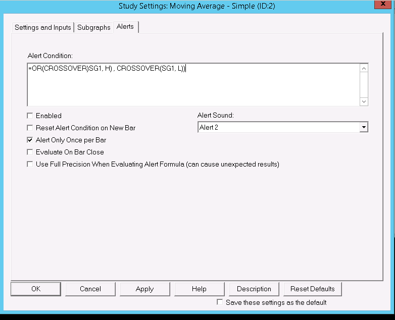

[2017-05-12 18:41:36]
User30653 - Posts: 13
File attached
imageScreenshot_2.png / V - Attached On 2017-05-12 18:41:08 UTC - Size: 13.69 KB - 396 views
[2017-05-12 18:50:06]
I guess like this as I can't screenshot the alert tab of the study through EDIT > SCREEN IMAGES, right?
[2017-05-12 19:34:33]
The answer is yes in response to post #10.
We now see what the problem is with this formula:
=OR(CROSSOVER)SG1, H) , CROSSOVER(SG1, L))
It needs to be:
=OR(CROSSOVER(SG1, H) , CROSSOVER(SG1, L))
