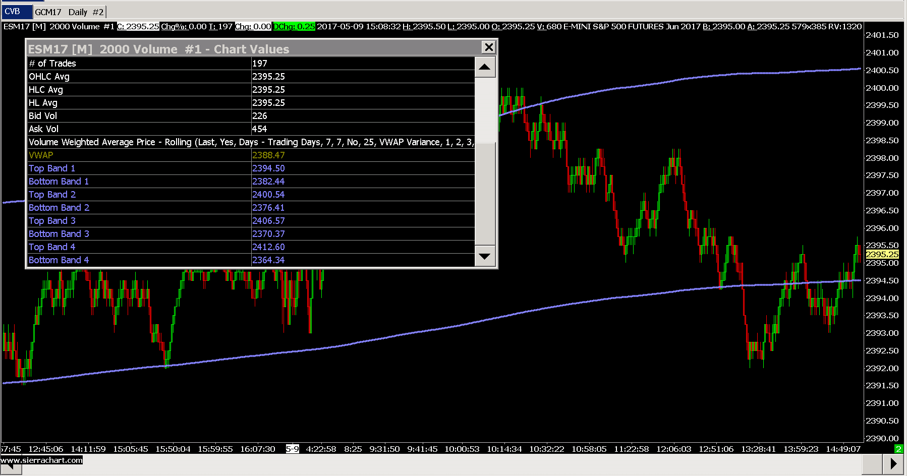

So far we have been running your Chartbook for several hours and no trouble. This is what we currently see:
http://www.sierrachart.com/image.php?Image=1494356915646.png
We have not done any full recalculation and see no evidence of the problem.
