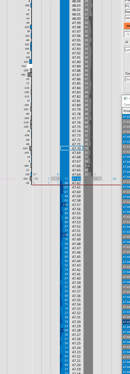

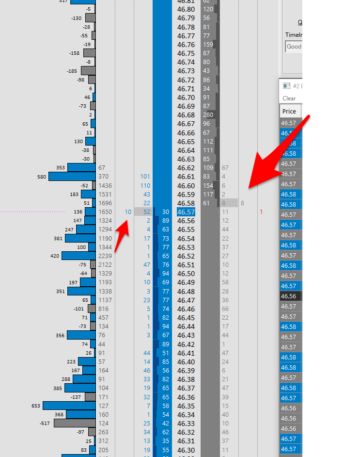

All of my DOM's and chart doms have lost pulling and stacking data. i have deleted the columns and re-added and its the same.

Adam - Posts: 141
HI
CQG is the provider
F.US.CLEM17
Tick is 0.01
Very odd but it just seems to show it for the current at the market price. See image

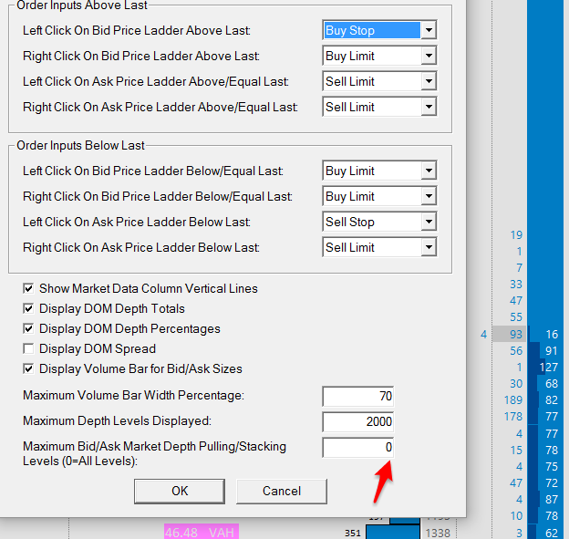

Make sure Global Settings >>Chart DOM Settings >> Maximum Bid/ Ask Market Depth Pulling/Stacking Levels is set to 0.
Date Time Of Last Edit: 2017-05-08 14:18:29
[2017-05-08 14:19:27]
Adam - Posts: 141
its 0

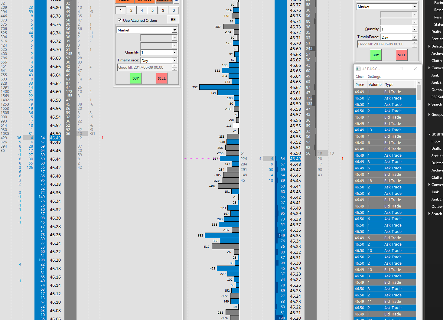

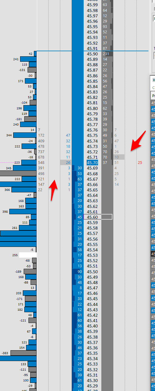

Adam - Posts: 141
its doing it on anther dom on another instance also
see image
Date Time Of Last Edit: 2017-05-08 14:21:19
imageScreenClip.png / V - Attached On 2017-05-08 14:21:07 UTC - Size: 229.43 KB - 816 views
[2017-05-08 14:24:37]
Adam - Posts: 141
jsut made a sub instance and its working
...now im confused.

[2017-05-08 14:44:32]
Adam - Posts: 141
i loaded the .cht to another instance and it works fine. see image
identical .cht on instance and sub instance
just wonder whats changed on the primary instance
imageScreenClip.png / V - Attached On 2017-05-08 14:44:30 UTC - Size: 173.25 KB - 547 views

Not sure about this at this point in time.
We see you are using the prerelease. You may want to go back to the current version. Here are instructions:
[2017-05-08 14:51:48]
Adam - Posts: 141
ive tried that and it the same
the sub is 1533 and its working
i rolled back to 1549 for both and its the same one works one doesnt.
i mush have turned something off on the primary i cant work out what :(

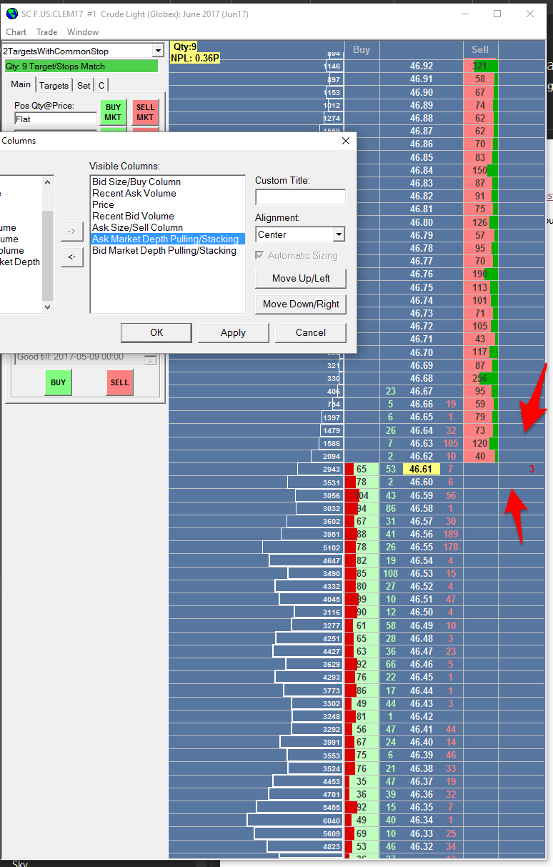

Open a new chart. Just a normal chart. Enable Trade >> Show Market Data Columns. Set the columns to display the Bid/Ask market depth and the pulling/stacking column. For the instructions, refer to:
http://www.sierrachart.com/index.php?page=doc/GlobalTradeSettings.html#CustomizeChartTradeDOMColumns
Let us know if you see the pulling and stacking column data.

[2017-05-08 18:45:35]
Adam - Posts: 141
No
See image, looks instance wide...

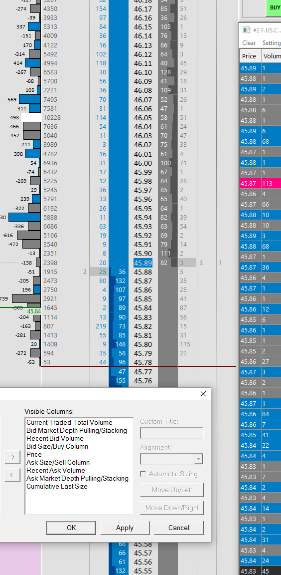

Adam - Posts: 141
Its not a DOM its a Chart DOM and i only have it saved with all the custom code on it so i cant share that
[2017-05-09 16:52:32]
Adam - Posts: 141
happy to share column config
see image
imageScreenClip.png / V - Attached On 2017-05-09 16:52:14 UTC - Size: 97.49 KB - 765 views

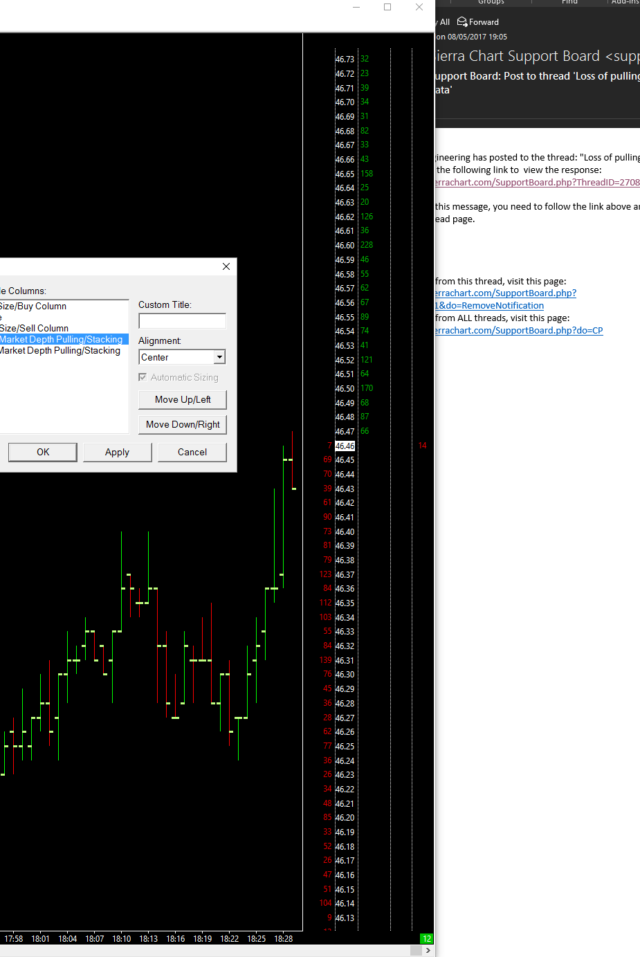

[2017-05-12 08:41:46]
Adam - Posts: 141
Looks like v1556 has not solved it
Im still seeing no pulling/stacking data
let me know if there is anything you want me to try
Adam
imageScreenClip.png / V - Attached On 2017-05-12 08:41:09 UTC - Size: 96.63 KB - 446 views
[2017-05-12 14:49:36]

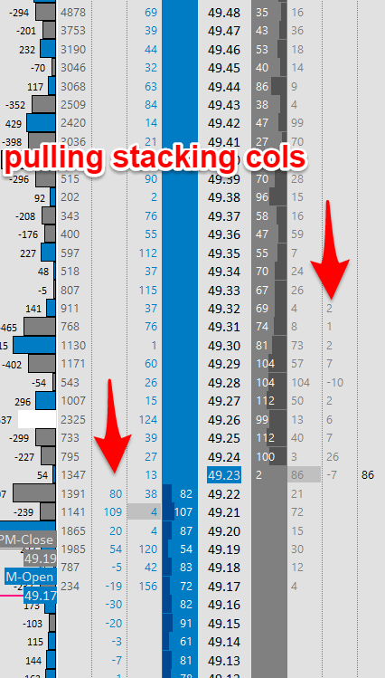

We do see one problem with the changes in 1556. And we have a couple other things we want to look at and work on. We are doing this now.
Also every time you post a screenshot, it is hard for us to understand it because we do not know what columns are for pulling and stacking data. You should add the column titles.

[2017-05-14 20:58:54]
Install prerelease 1557.
If you still have a problem, then is it a case where the market depth pulling and stacking data never appears or just one level appears? Or is it a case where it appears but sometimes fully clears unexpectedly?
Date Time Of Last Edit: 2017-05-15 14:10:24
[2017-05-15 13:40:35]
Adam - Posts: 141
Looking good! thanks so much
imageScreenClip.png / V - Attached On 2017-05-15 13:40:18 UTC - Size: 132.02 KB - 510 views
