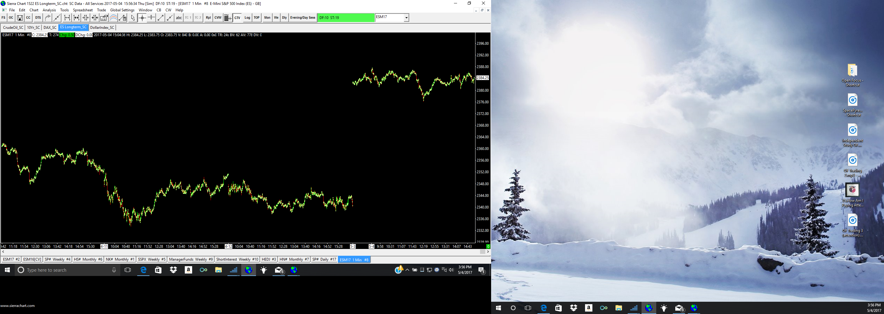

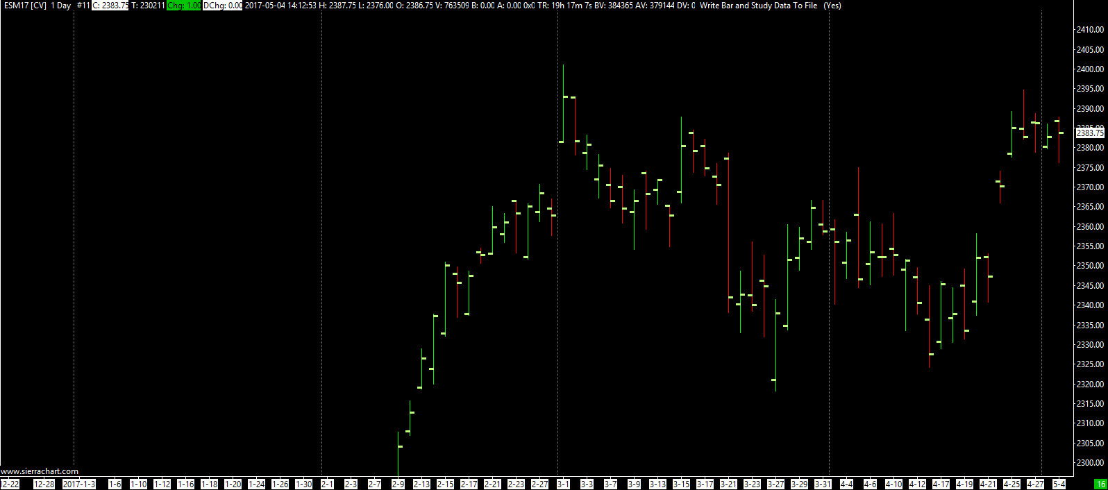

[2017-05-04 19:01:30]
WarriorTrader - Posts: 259
http://www.sierrachart.com/image.php?Image=1493924463732.png
[2017-05-04 19:02:25]
http://www.sierrachart.com/image.php?Image=1493924531406.png
[2017-05-04 19:04:59]
We made sure the data is identical on both of our servers and there is no data loss. Re-download the data.
Date Time Of Last Edit: 2017-05-04 19:05:34

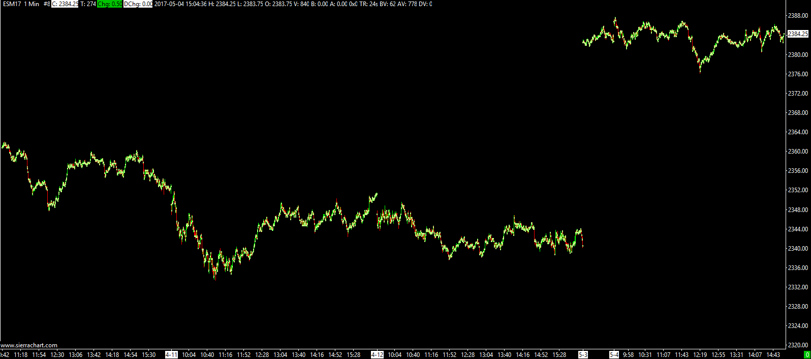

[2017-05-04 19:18:24]
I deleted and updated from two weeks ago onward. Now there is a two week gap in my data. Please fix and yesterdays low is still incorrect.
http://www.sierrachart.com/image.php?Image=1493925395252.png
Thx,
WT
[2017-05-04 19:43:15]
What is Global Settings >> Data/Trade Service Settings >> Service set to?
If it is Gain Capital, then you are using the wrong symbol in the chart. It needs to be ESM7. With a single-digit year.
There is no problem with the data. This is for certain.
Date Time Of Last Edit: 2017-05-04 19:43:30

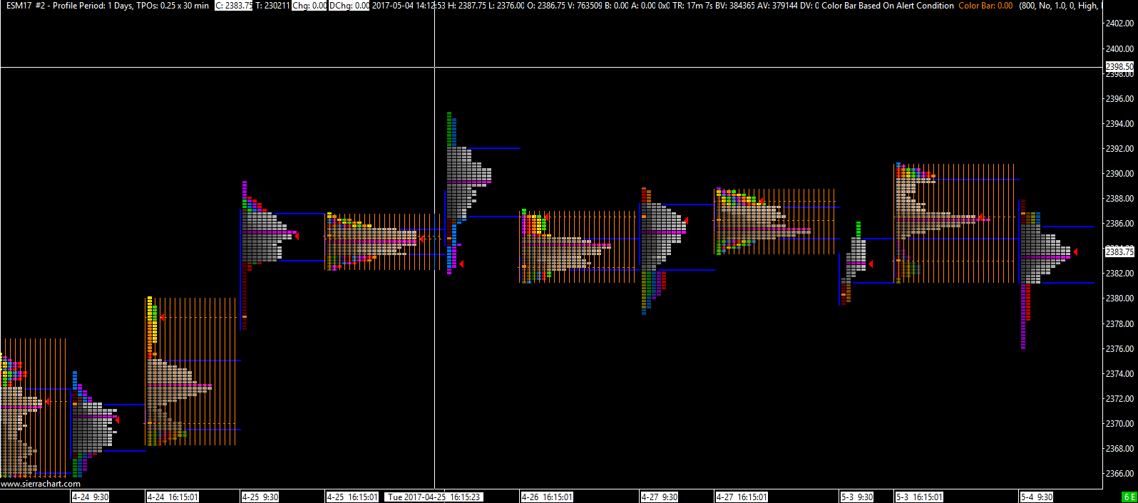

[2017-05-04 19:55:16]
You should not be having a problem unless it has something to do with the old version 1225. That could be it.
There is no problem with the historical data on the server.
Install the current version of Sierra Chart on your system into another folder and test with that. You should not have any difficulty.
[2017-05-04 19:55:22]
http://www.sierrachart.com/image.php?Image=1493927805758.png
Date Time Of Last Edit: 2017-05-04 19:56:53
