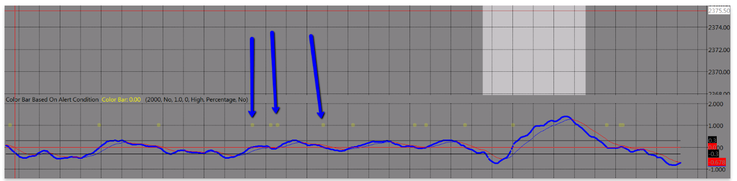

I would like to draw a Transparent Circle when the MACD crosses above or below Zero. I also need this Transparent Circle to display on the zero line itself (which I have drawn in w/ the horizontal line study).
Thoughts?
[2017-05-01 14:19:23]
User28914 - Posts: 87
Figured out the Alert part, however, how do I get the Transparent Circles to be drawn along the Zero line (not at the top of the region - see attached)
Date Time Of Last Edit: 2017-05-01 14:20:46

[2017-05-02 05:36:04]
We need to add support for drawing zeros with the Color Bar Based on Alert Condition study.
This will be out tomorrow.
Date Time Of Last Edit: 2017-05-02 05:36:31
[2017-05-02 12:03:00]
Great news! TY
[2017-05-02 16:50:07]
Actually, we came to an incorrect conclusion.
You need to set the Line study at zero to a value close to zero like .001 and follow through the instructions here:
http://www.sierrachart.com/index.php?page=doc/ColorBarBasedOnAlertCondition.php#s252_ColoringSubgraphsOfOtherStudies
[2017-05-02 17:20:46]
Not following....do you mean the Horizontal Line Study? I have a line set to Zero. I have the Color Bar based on Alert Condition setup perfectly, just need the drawing to be a transparent circle on the zero line when the MACD crosses through it.
[2017-05-02 17:49:21]
Yes.
Set that to .001
[2017-05-02 18:14:40]
Awesome! Got it, thank you!
