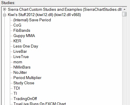

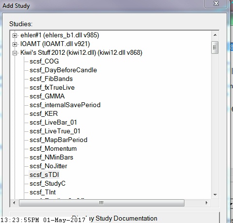

Here are the studies listed in the two versions of SC. Ver 1531 has the Kiwi T1 file and Ver 1544 does not.
In fact all names in the ver 1544 KiWi section are changed and T1 is now absent. I tried to attach jpg image files, doesn't seem to have worked.
The indicators in question are located in the Kiwi's Stuff2012(Kiwi12.dll) (Kiwi12.dll v868) User indicator area available after pressing F6,
The T1 has been around since 2012 or earlier. How can it get restored?
Regards
imagekiwi T1 showing in SC ver1531.jpg / V - Attached On 2017-05-01 18:40:40 UTC - Size: 47.01 KB - 562 views
imagekiwi T1 missing in SC ver 1544.jpg / V - Attached On 2017-05-01 18:41:49 UTC - Size: 70.24 KB - 540 views
[2017-05-01 19:30:57]
The source code for these really does need to be recompiled.
Although, we do not know where the source code is for these studies.
Anyway, just update to the current version following these instructions here:
http://www.sierrachart.com/index.php?page=doc/SoftwareDownload.php#FastUpdate
That will resolve the problem.
