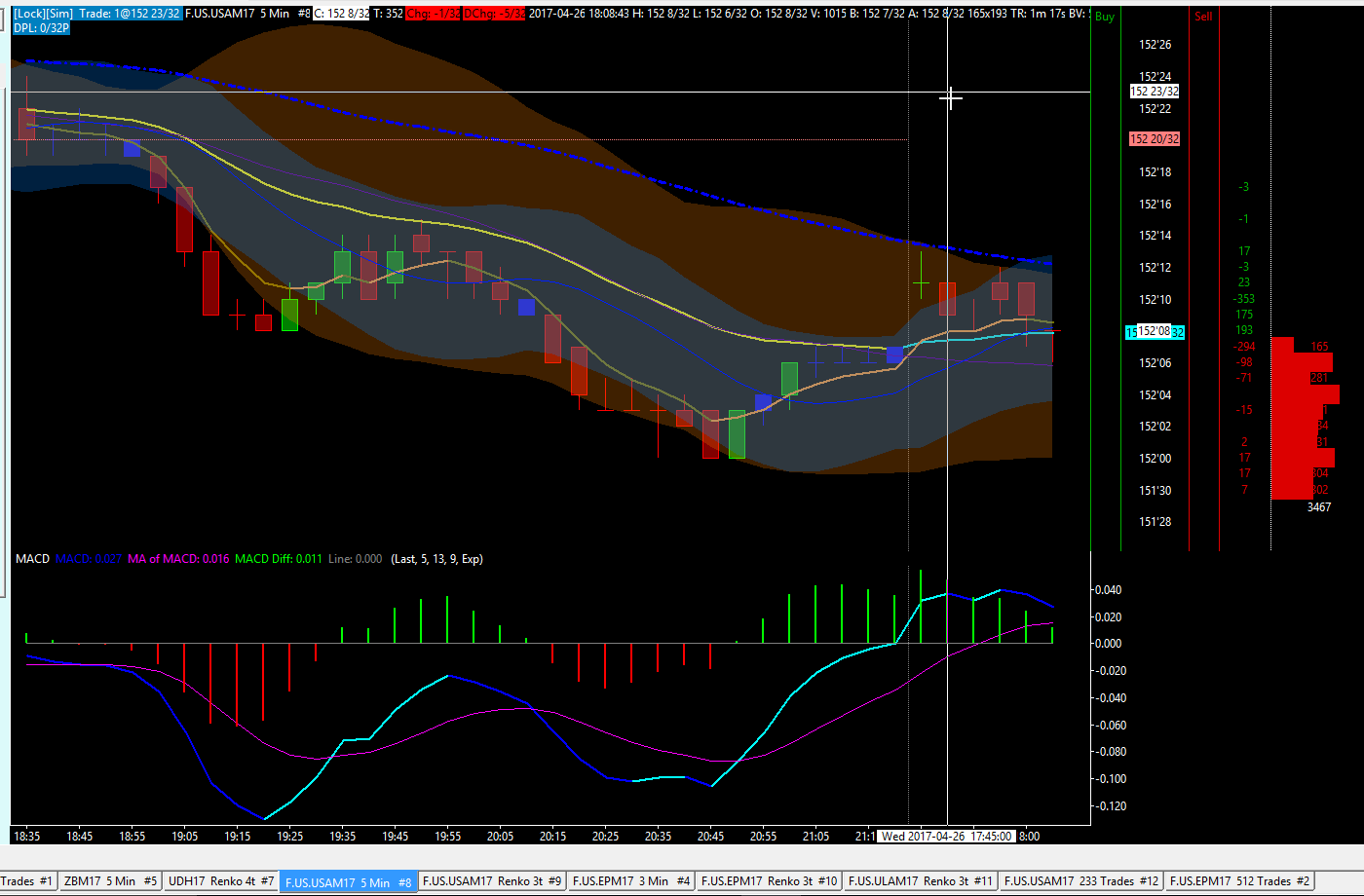

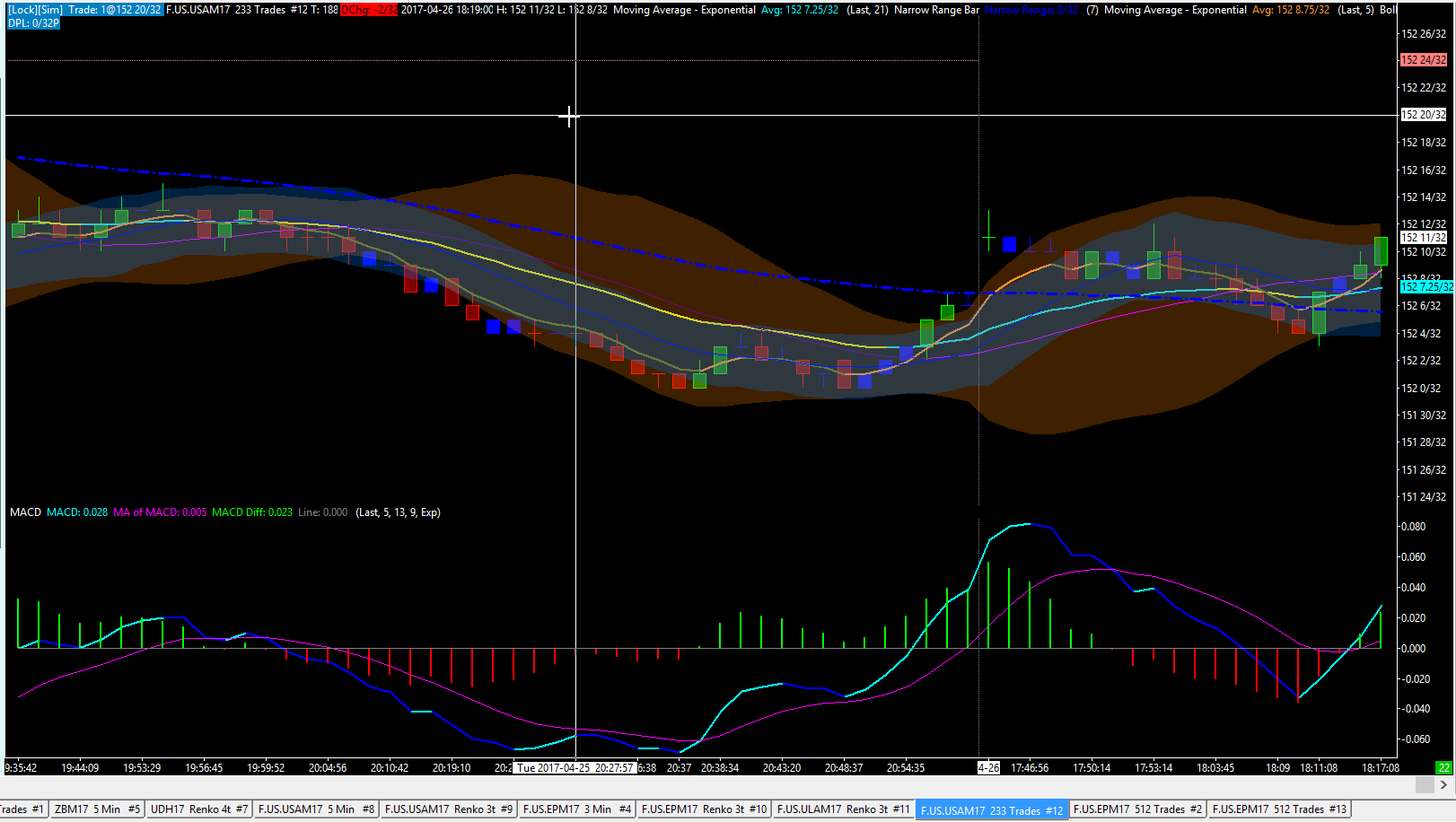

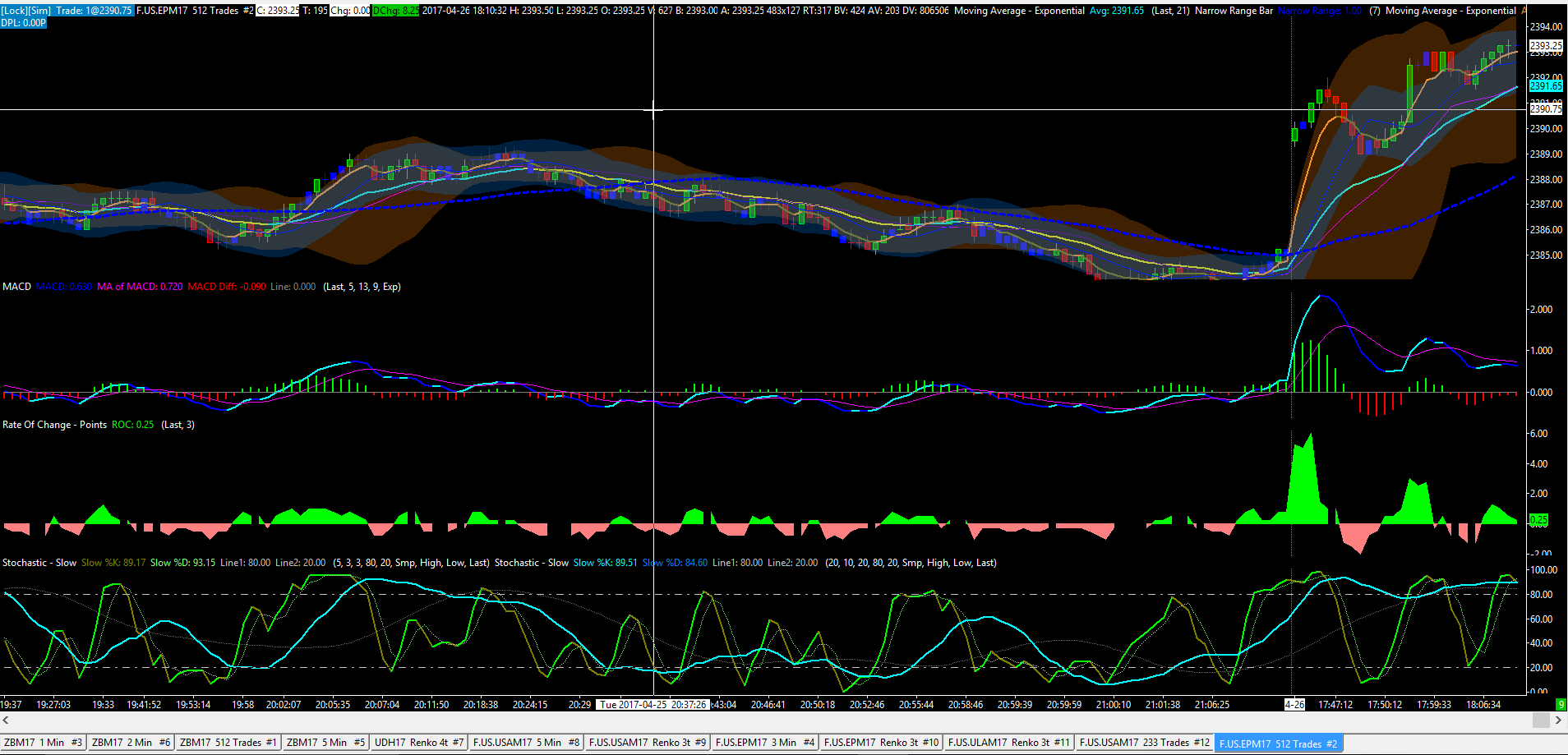

I'm using live CQG Web API feed (via AMP Futures live trading account) and recently (several days) I have noticed missing large chunks of data - e.g. bars start drawing only from 6pm or from 2pm and whole hours go missing, even if selecting 1 or 5 minute bars or even if I have 233 or 512 tick bars.
It happens both on 30 yr T-bond as well as on S&P500 E-mini.
My account is active, I have paid for subscription and my network connection (both wired and WiFi) are good.
Initially I thought that maybe I have selected more narrow trading hours for data in the Chart Settings but they are set from midnight to 23:59 so that's not it. What the hell is going on, I wonder?
I've tried uploading chart images using your own suggested method from here (https://www.sierrachart.com/index.php?page=doc/PostingInformation.php#Image) but it keeps failing (see the log) - yet another issue.
Thus, I've attached the images as files.
can you please investigate?
Attached examples.
Thanks,
G.
image2017-04-26 18_08_46 - FUSAM17 5 min.png / V - Attached On 2017-04-26 17:12:14 UTC - Size: 61.86 KB - 322 views
image2017-04-26 18_19_12 FUSAM17.png / V - Attached On 2017-04-26 17:20:26 UTC - Size: 64.48 KB - 375 views
image2017-04-26 18_10_34 F.US.EPM17.png / V - Attached On 2017-04-26 17:20:36 UTC - Size: 97.66 KB - 391 views
[2017-04-26 18:09:31]
Follow through the instructions here:
http://www.sierrachart.com/index.php?page=doc/HistoricalIntradayData.html#RetryDownloadDataInChart
Sounds like you have a firewall blocking the historical data connection.
