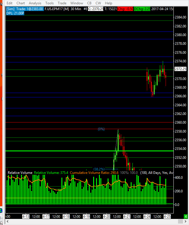

My relative volume study is showing inaccurate data from what I can see. When I first put it on the chart it looked accurate, now it's showing almost every 30 min bar at 200% and higher with a lot of the bars at 400%. This is obviously inaccurate. Please take a look at the settings and let me know. Thanks.
imagerelativevol.jpg / V - Attached On 2017-04-25 07:43:45 UTC - Size: 202.82 KB - 422 views

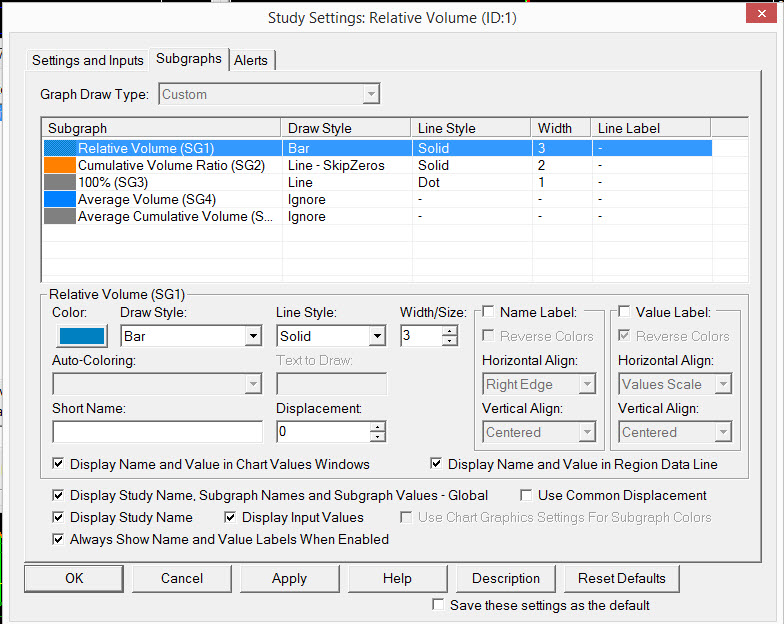

imagerelvolsettings.jpg / V - Attached On 2017-04-25 07:44:10 UTC - Size: 157.16 KB - 424 views
imagerelvolsettings2.jpg / V - Attached On 2017-04-25 07:44:19 UTC - Size: 181.77 KB - 336 views

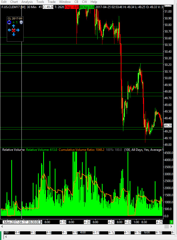

Here is crude which looks even more inaccurate.
imagerelativevolcrude.jpg / V - Attached On 2017-04-25 07:55:45 UTC - Size: 222.38 KB - 414 views

There are two problems here. Refer to:
http://www.sierrachart.com/index.php?page=doc/StudiesReference.php&ID=356#s356_ContinuousFuturesContractCharts
You need to set the chart to a Continuous Futures Contract chart.
And also read the description for the Period - Days to Include Input here:
Relative Volume

[2017-04-26 07:15:20]
User968091 - Posts: 49
I used Continuous Futures Contract- Date Rule Rollover for the ES. Is that setting sufficient for Crude and Gold or should I use something else?
[2017-04-26 17:08:53]
Refer to:
http://www.sierrachart.com/index.php?page=doc/ContinuousFuturesContractCharts.html#UsingDateRuleVolumeBasedRollover
For commodities like gold and crude oil, you should use a volume-based rollover.
