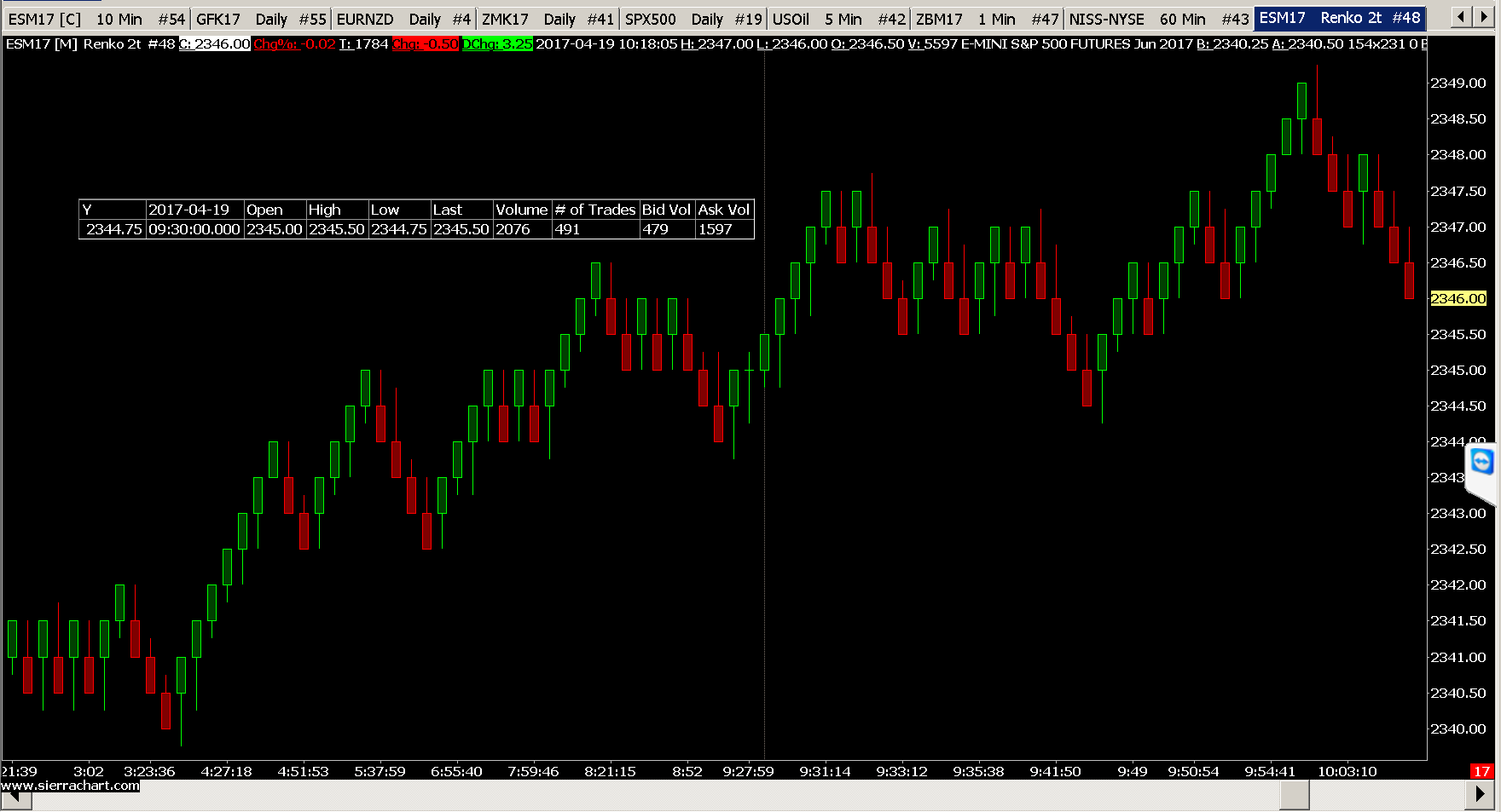

[2017-04-19 17:43:41]
First, that chart is way too complicated for it to be of any use to us.
It does not follow our specifications documented here:
We also are not fully understanding what you are trying to say here:
So the chart for the daily session is showing incorrect and misleading data
What chart are you referring to?
Here is a Renko 2 tick chart showing the open:
http://www.sierrachart.com/image.php?Image=1492623711652.png
In the Chart Settings, this chart has New Bar at Session Start enabled which must be the case.
Date Time Of Last Edit: 2017-04-19 17:44:42

[2017-04-19 21:31:44]
Uncheck Chart >> Chart Settings >> Fill Session Gap.
And you must enable New Bar at Session Start.
