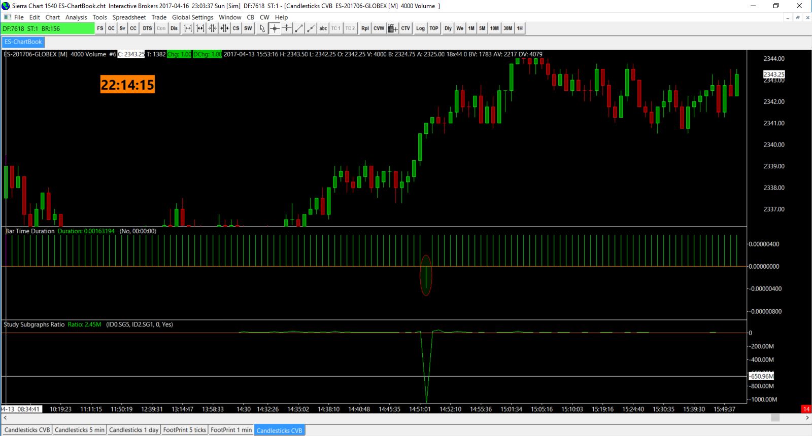

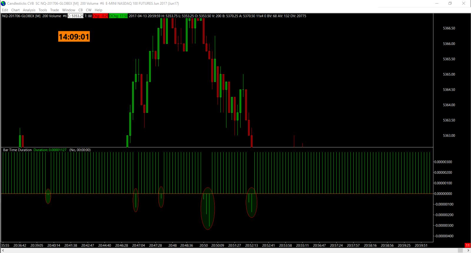

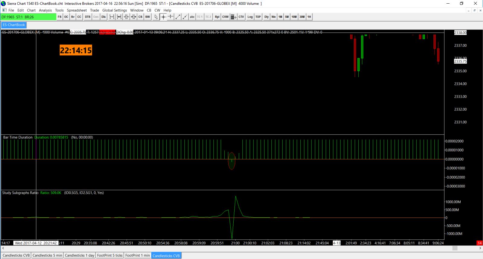

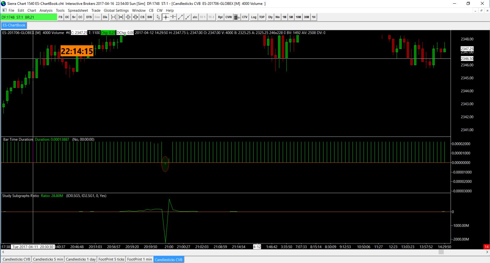

I'm using CVB (Constant Volume Bars) for e-mini ES and NQ futures.
I need to calculate the velocity of the volume in lots/sec, but I have a problem with the bar time duration when volumes run very fast:
as you can see from the attached pictures (highlighted by the ellipses) the bar time duration in some cases became negative and obviously this is not possible.
Is it possible to solve this issue?

imageES - Negative Bar Time Duration 1.JPG / V - Attached On 2017-04-17 13:40:39 UTC - Size: 152.57 KB - 513 views
imageES - Negative Bar Time Duration 2.JPG / V - Attached On 2017-04-17 13:40:44 UTC - Size: 141.62 KB - 479 views
imageES - Negative Bar Time Duration 3.JPG / V - Attached On 2017-04-17 13:40:56 UTC - Size: 156.08 KB - 483 views
imageNQ - Negative Bar Time Duration.JPG / V - Attached On 2017-04-17 13:41:01 UTC - Size: 138.49 KB - 512 views

NQ-201706, today price action with CVB=200 lots/bar, in the bar time duration study you can see:
- 5 negative bars starting from 15:15:05 to 15:15:06
- 1 negative bar at 15:16:23
http://www.sierrachart.com/image.php?Image=1492441068723.png

psavi73 - Posts: 39
I hope that this image with the zoom in the Bar Time Duration graph could help.
http://www.sierrachart.com/image.php?Image=149246843071.png
