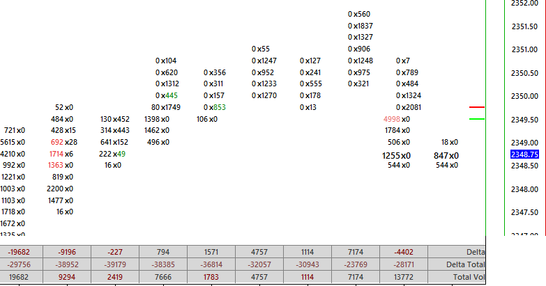

why having all bids or all offers as 0 on number bars?
see attached, happened just now,
image2017-04-11_16h37_26.png / V - Attached On 2017-04-11 13:37:43 UTC - Size: 19.01 KB - 391 views

We see you are using Gain Capital. This must have been due to a data feed issue. Looks like it was an issue with the market depth data not updating.
Try re-downloading the data following the instructions in help topic 2.1.2:
http://www.sierrachart.com/index.php?page=doc/helpdetails2.html#h2.1.2

all other instruments except ES are printing correctly, ES prints a couple of minutes after reconnect and then starts printing 0 on either bid on ask, see attached
are you sure there is nothing to look into in SC?

[2017-04-19 17:16:45]
The screenshot in post #5 showing that the Bid and Ask prices are not accurate is the reason for the problem and this is a Gain Capital data feed issue.
We have reported this general issue to them a few weeks ago.
