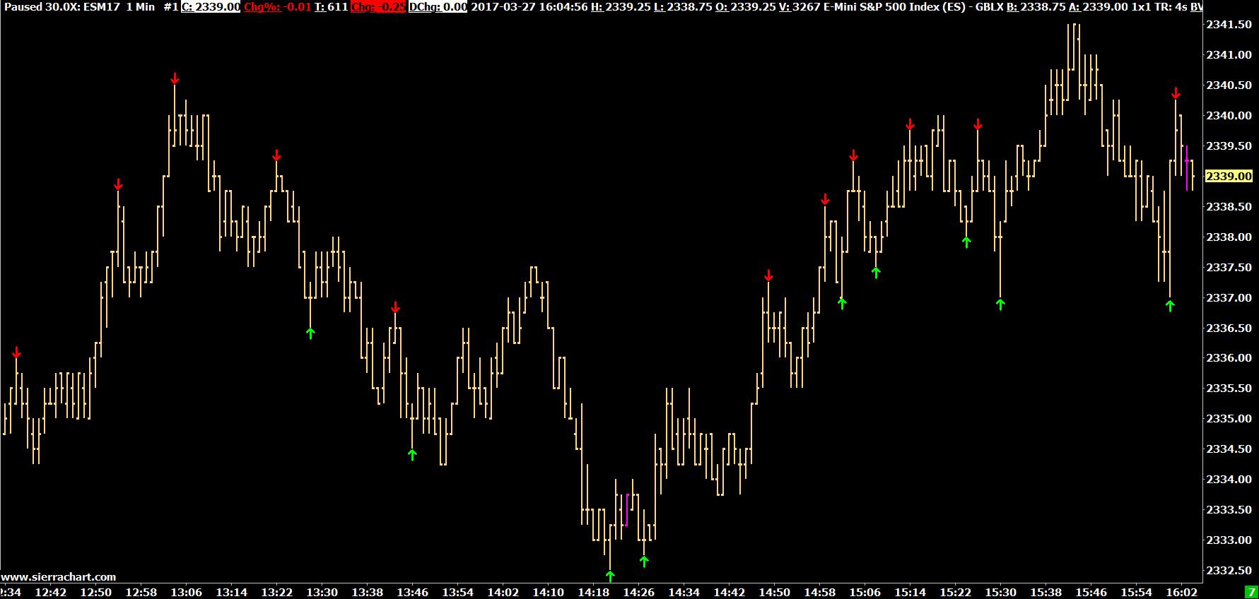

I am trying to create a color bar when the last swing bar low (highlighted by an arrow) is higher than than the previous swing bar low. The swing bar low is ID1.SG2 and the length is 3. I'm still not sure what the length means in the indicator. I currently have =AND(ID1.SG2[-3]>ID1.SG2[-6],C[-3]>C[-6]) and it works, but it colors the bar way after the swing bar arrow comes on the screen. Essentially I want to color a bar as soon as the swing low is shower a higher low.

The Swing High and Low study draws the arrows when the length is reached, so there will be a lag of that many bars.
You can easily extend the previous swing high/low to the next one with a spreadsheet study, and color a bar when there is a higher low or a lower high. Post again if you want the details.

We tested the formula in post #1 and this is what we see:
http://www.sierrachart.com/image.php?Image=1490664819888.png
We also tested this during a replay and the coloring of the bar was at the expected time. As soon as the swing high/low arrow appears and the condition has been met, the bar is colored.

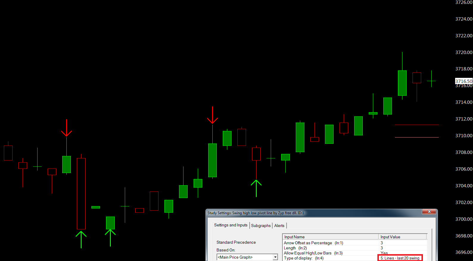

User135370 - Posts: 162
Any way to do this with the normal Trading System based on Alert condition colour bar on alert condition?
So for a short signal want to include that the recent Swing High is Lower than the previous Swing High and vice versa for a Swing Low.
Is there a way or must I use the Spreadsheet?
