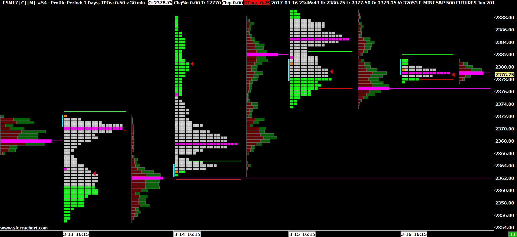

Hello Sierra Chart Support, I have the Volume Profile added to my TPO chart. If I want to extend VPOC until future intersection, I can do that only if I had 'POC based on Volume' enabled on the TPO chart. Instead if I want to use the POC from my volume profile, even though there is an option to extend POC until future extension, it doesn't seem to work. Please do the needful. Appreciate your support.
Thank you.
[2017-03-17 03:48:14]
Extending the point of control Until Future Intersection with the Volume by Price study when used with the TPO Profile Chart study is supported. Refer to:
http://www.sierrachart.com/image.php?Image=1489722416196.png
Be sure you set this on the Volume by Price study itself. Refer to:
https://www.sierrachart.com/index.php?page=doc/VolumeByPrice.php#Input_ExtendPointOfControl
[2017-03-17 16:19:40]
pipsmart - Posts: 15
Thanks for the prompt response. Just so you know, I tried again exactly as you said but, am not able to extend NVPOC until future intersection but, I tried again with the Naked TPO POC. Am able to extend that until future intersection.

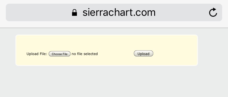

Thank you. I don't seem to find the 'Private' option under 'Add/Edit Attached Files' as mentioned in the documentation. Please advise.

[2017-03-18 00:54:43]
Correct. I tried Safari / Chrome & Firefox. It's plain without the links.
imageIMG_7646.PNG / V - Attached On 2017-03-18 00:52:38 UTC - Size: 22.16 KB - 613 views
[2017-03-18 00:58:24]
Actually, you know what? Unlike your document, thhe 'Private' option shows after the file is uploaded. Not before. I will send the chartbook once I reach home.
[2017-03-18 10:07:28]
The documentation does state to upload the file and then the next step is to use the Make Private command. See step #7 here:

This problem is now resolved in the latest revision of pre-release 1530.
[2017-03-20 01:43:13]
Perfect. I can see that it is resolved. Since we are on this topic, one request that is not urgent but, would help if we can have it in the upcoming releases. It would help to have a separate Subgraph 'Point of Control Extension Line' for 'Volume by Price' like we have for 'Numbers Bars'. This will allow me to label Naked POCs correctly. Else, can't differentiate. Not a big deal but, would help.
Thanks for all the quick and prompt support. You guys rock.
[2017-03-20 02:27:00]
This is now supported.
You can set a Short Name on the Point of Control subgraph with the Volume by Price study and enable the Name Label. It will now be displayed.
