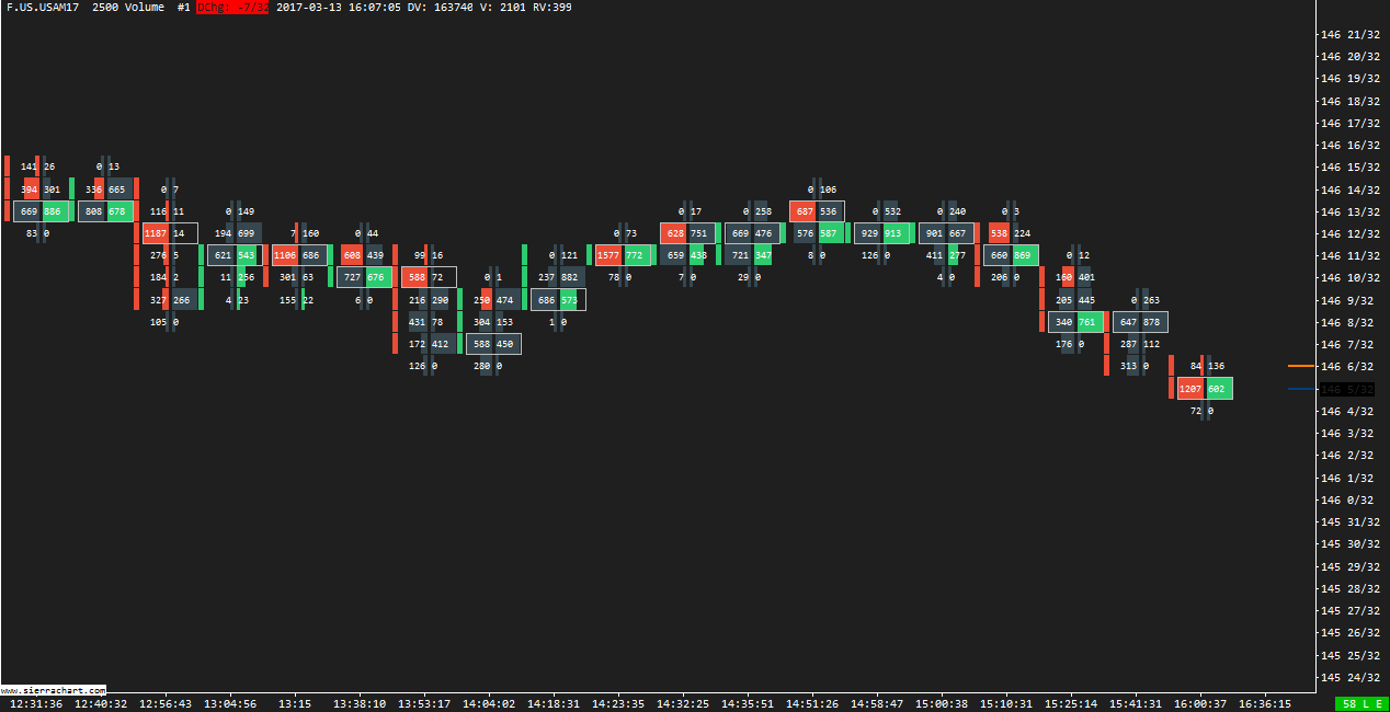

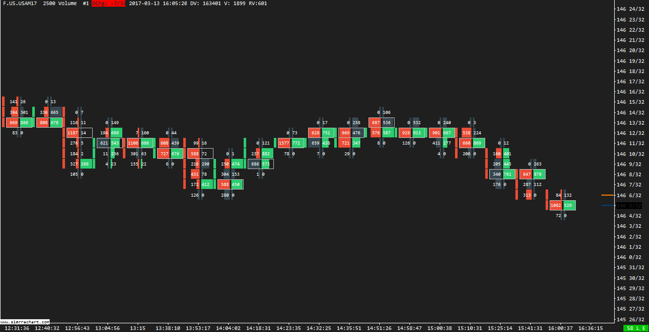

I have experienced some problem with the Numbers Bars Diagonal Dominant Background coloring method since the last update (1528). Wanted to let you know if you are not aware of it.
Please see the following two charts:
v1528 pre-release
http://www.sierrachart.com/image.php?Image=1489435521802.png
v1527
http://www.sierrachart.com/image.php?Image=148943562642.png
Both charts use the exact same settings: 200,300,400 % is used to set the coloring threshold and color only the sides when the difference is more than 400%.
The v1527 bars are correctly colored, but there are numerous issues with the 1527 colors: one example at the second bar on the v1528 chart the difference of bid 808 and ask 665 is colored.
Tried to modify threshold (%) settings in v1528 but nothing changes.
Now after rolled back to v1527 everything works perfectly again.
Thank you!
