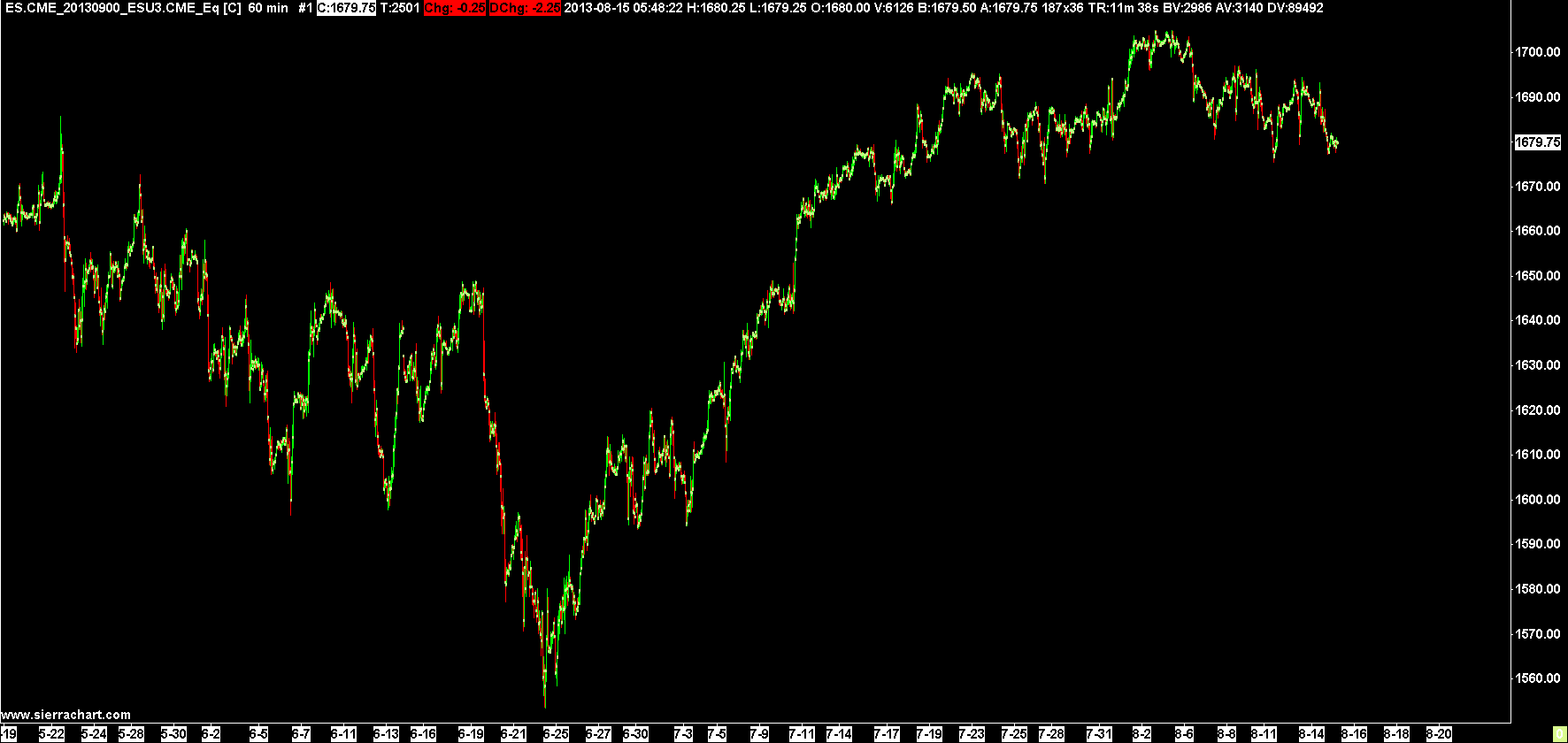

This is still fully supported with CTS. Please see this image:
http://www.sierrachart.com/image.php?l=1376560116661.png

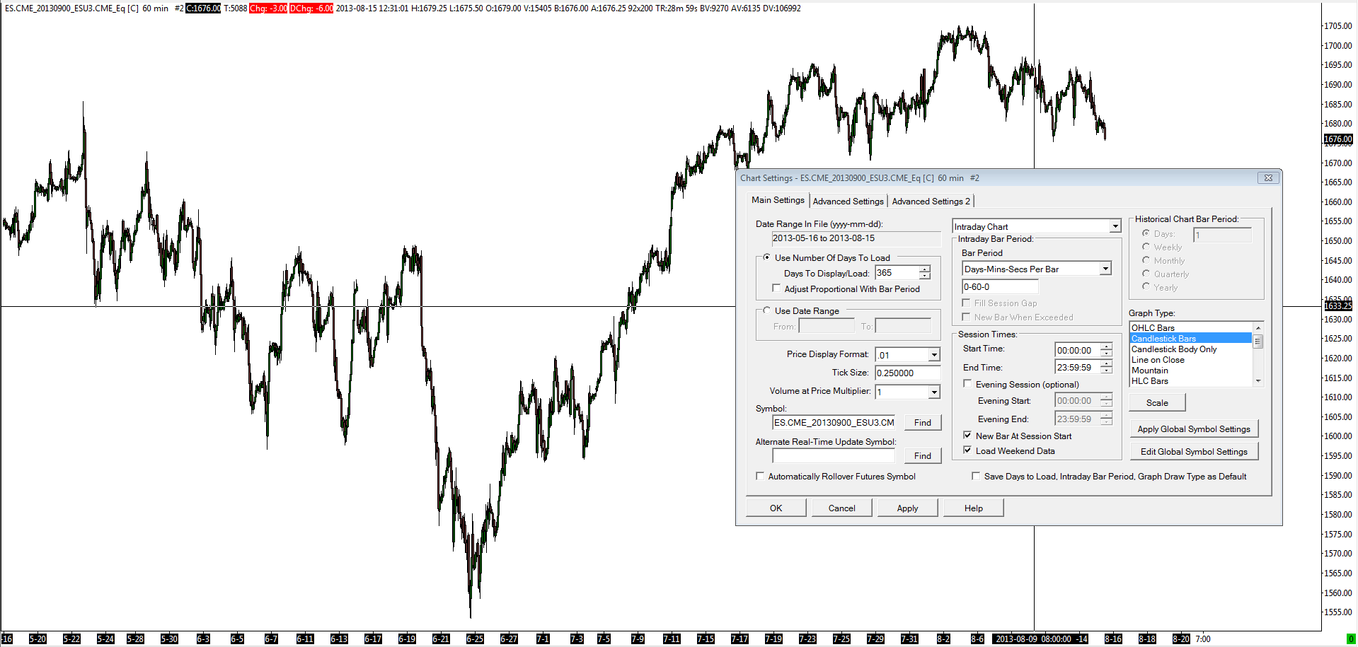

[2013-08-15 10:37:05]
Futurestrader77 - Posts: 126
Thank you for your response!
Your chart and mine is only going back to 5-17. It seems that is not possible to create a longer countinuous futures contract! Please see the image I attached, there you see that I want a long term future contract chart back 365 days. But the chart always start at 5-17. So I was assuming that Method 1 http://www.sierrachart.com/index.php?l=doc/doc_ContinuousFuturesContractCharts.html does not work anymore.
With the older versions I didn´t have any problem with that!
Best Regards,
Thomas
imageES Continuous.PNG / V - Attached On 2013-08-15 10:35:18 UTC - Size: 114.14 KB - 763 views

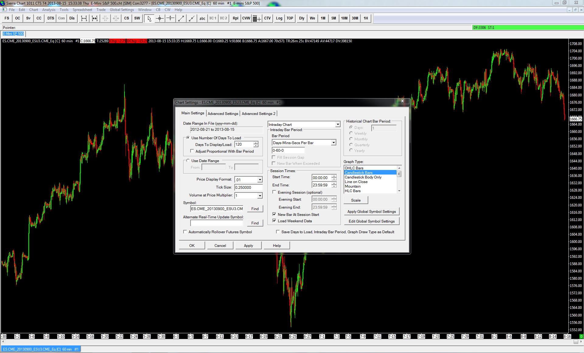

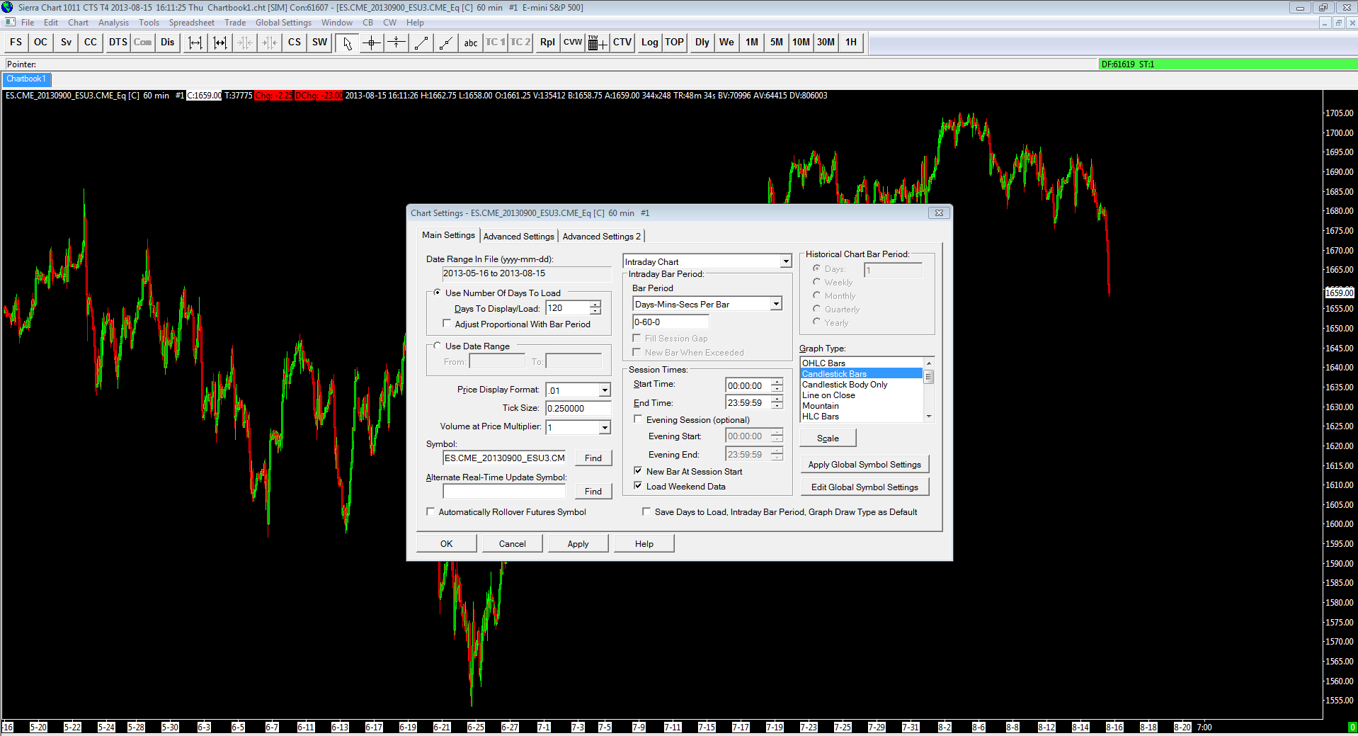

[2013-08-15 14:16:06]
I´m still having problems to create a continuous futures contract, but only with my Desktop PC. It´s very strange but with my Notebook all works fine. I attached two images where you can see the difference.
I unistalled Sierra and installed it on both PC´s, only on the Notebook it works and not the Desktop PC.
Is it possible that the new version has a hardware conflict?
imageES PC.PNG / V - Attached On 2013-08-15 14:14:16 UTC - Size: 124.1 KB - 743 views
imageES Notebook.PNG / V - Attached On 2013-08-15 14:14:21 UTC - Size: 199.8 KB - 785 views

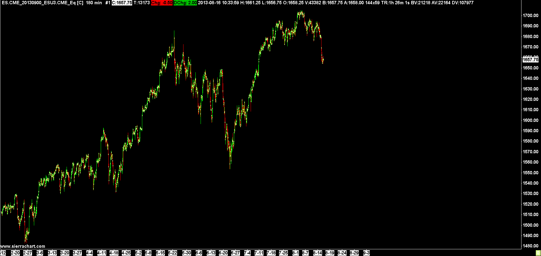

[2013-08-16 08:36:50]
This specification you have given is getting pretty extreme with CTS in our opinion. It will take a long time to get that data and we wonder what problems might be encountered. We did not try that.
We did do 6 months using 1 minute data:
http://www.sierrachart.com/image.php?l=1376642100434.png
