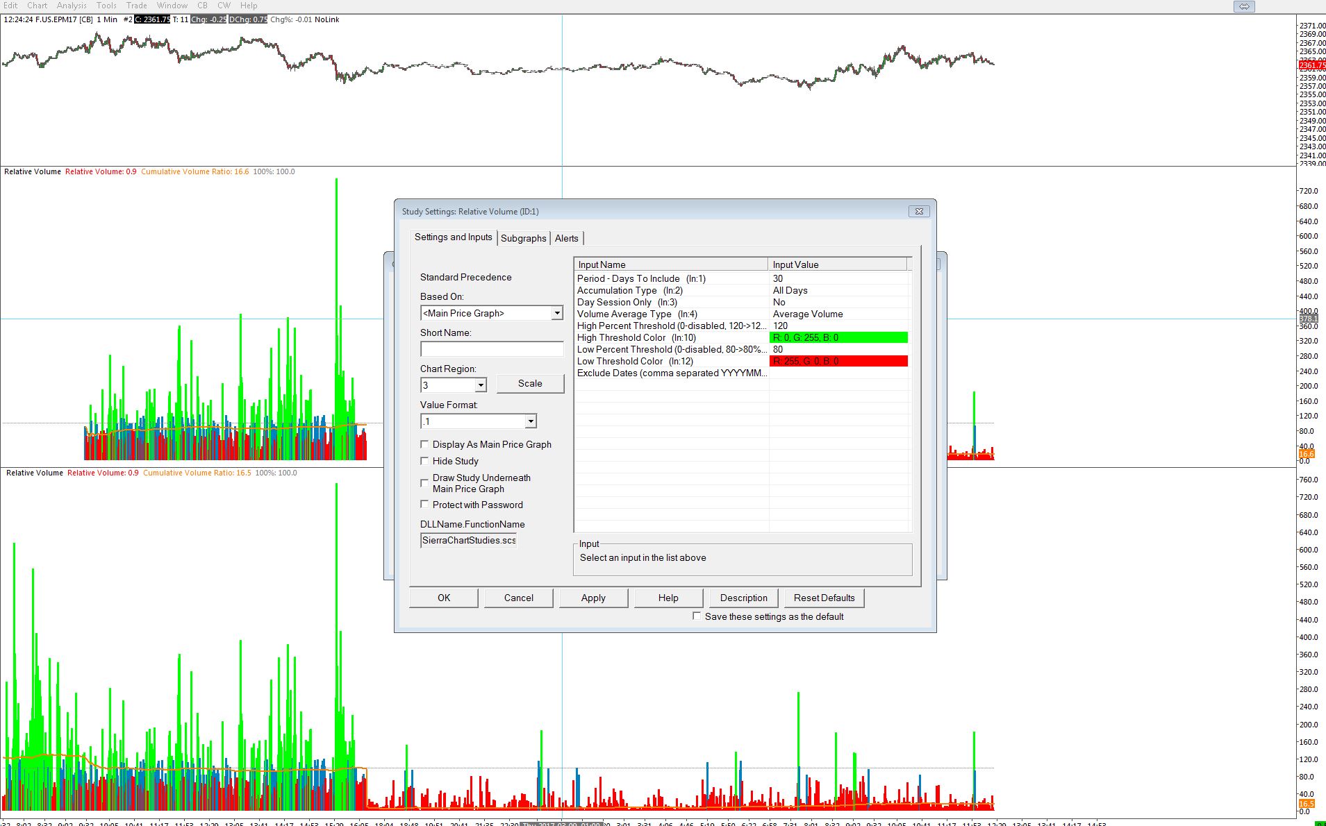

after I performed the rollover today now I see a rel Vol in ES of 17% which I doubt is right.
What am I doing wrong, or what setting do I need to change/adjust?

You just need to look at the historical data being referenced in the chart based upon the Period-Days to Include Input setting to make sure the bar volume is correct and the data is there.
Add the Volume study to the chart.
Make sure the chart is a Continuous Futures Contract chart:
http://www.sierrachart.com/index.php?page=doc/ContinuousFuturesContractCharts.html

AKR - Posts: 542
have a look at my screenshots pls. I never had the volume study in there. I did now but that didnt change it.
imageUnbenannt1.JPG / V - Attached On 2017-03-09 17:26:08 UTC - Size: 273.32 KB - 377 views
imageUnbenannt.JPG / V - Attached On 2017-03-09 17:26:16 UTC - Size: 259.1 KB - 405 views

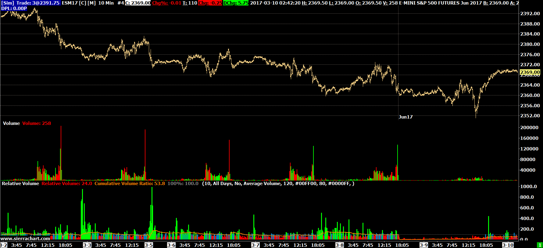

We wanted you to look at the Volume study, so you can understand the result that you are getting.
The result you are getting is correct because the volume is lower. You can see this here:
http://www.sierrachart.com/image.php?Image=1489131778989.png
