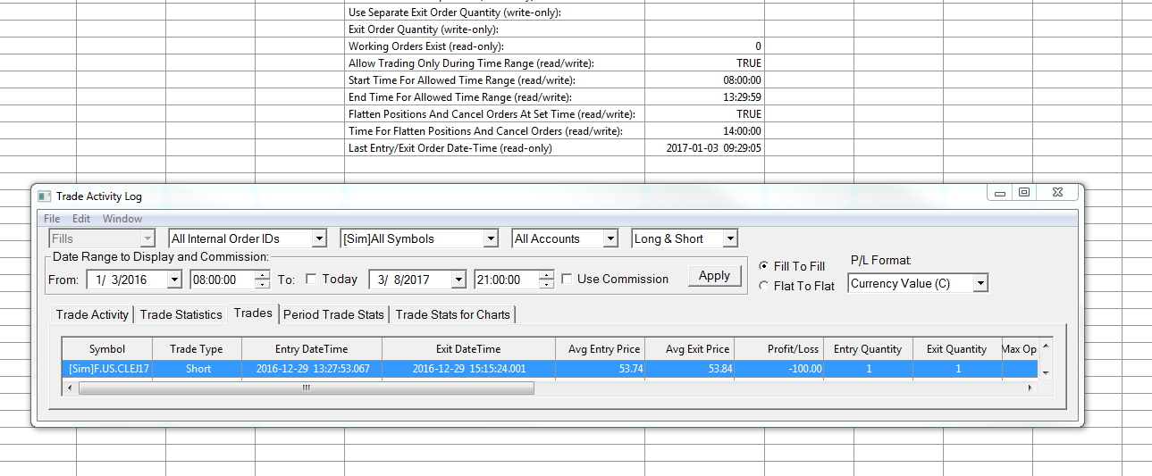

Please see attached screenshot. In the spreadsheet for trading study, I set "Flatten Positions and Cancel Orders" to TRUE and put 14:00:00 as the time to flatten positions but it doesn't seem to be working correctly. I attached an example of it not flattening the positions as referenced in the spreadsheet. Am I missing something here? Thanks in advance.

[2017-03-09 17:35:45]
Is the time zone of the chart using the global time zone setting?
Refer to:
http://www.sierrachart.com/index.php?page=doc/TimeZone.html
Also was there trading activity at 14:00:00? This is needed for the Flatten operation to happen at that time.
What is the timeframe of the chart bars?
Are you able to consistently reproduce the issue by setting the time to flatten to a few minutes ahead of time and waiting for it to be encountered?
[2017-03-09 18:17:03]
User794640 - Posts: 33
Yes, the chart is using the global time zone setting, which I have set to central (chicago) time.
I've tested with both 5 minute and standard range bars.
It's the front month crude oil futures market, it may not be super busy at 14:00:00 but there are definitely trades every minute.
I'm working replicating it again with different time and bar increments and will update.
