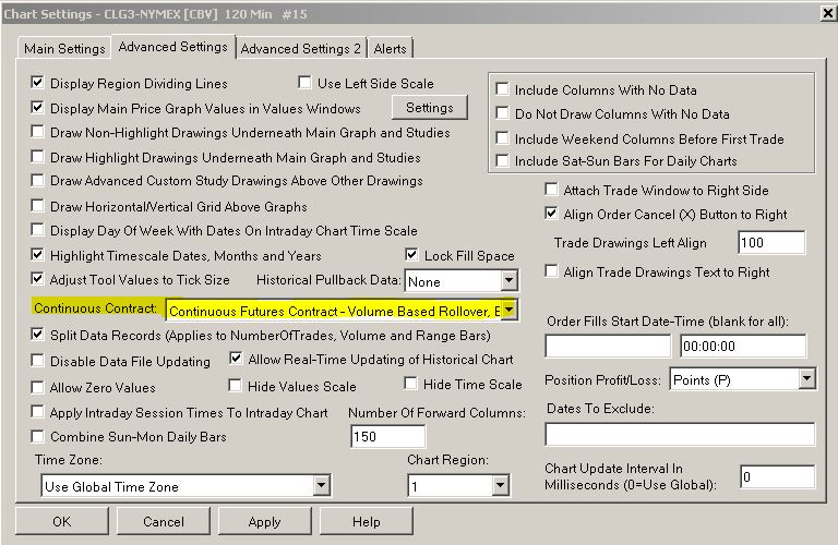

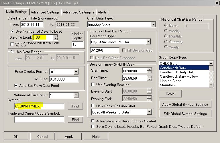

User497973 - Posts: 15
If I set my chart to "Continuous Futures Contract - Volume Based Rollover" (in the chart settings), the chart will load prices going back ONLY to 2012. Please see attached for screenshots.
If I try to load CLG09, it gives me an error "download failed".
CLG3 does load data, BUT CLG2 does not.
Is there something I can do to load/download more data?
Thanks!
imageCapture1.JPG / V - Attached On 2017-03-06 21:04:36 UTC - Size: 101.49 KB - 370 views
imageCapture2.JPG / V - Attached On 2017-03-06 21:04:44 UTC - Size: 95.49 KB - 315 views
[2017-03-06 21:32:10]
This is true and the Message Log does indicate the reason. It is because Rithmic uses single-digit years in the futures contract symbols.
The only way to overcome this is to use another copy of Sierra Chart set to use the Sierra Chart Historical Data Service:
Sierra Chart Historical Data Service: Setup Instructions
Date Time Of Last Edit: 2017-03-06 21:32:37
