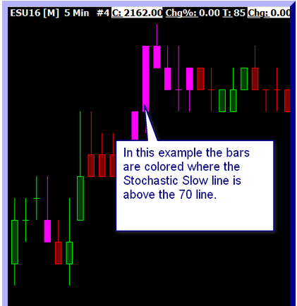

I currently have the following in two different instances of Color Bar Based on Alert Condition...
=CROSSFROMBELOW(ID5.SG1,ID5.SG2) Blue Color
=CROSSFROMABOVE(ID5.SG1,ID5.SG3) Magenta Color
This works fine, but what I'm trying to do is... have all the bars remain Blue or Magenta when they are above 80 or below 20. Not just the bar that crosses. (I'm trying to accomplish what's happening in the attached image. Notice that all the bars above the 70 line in the image example are Magenta).
