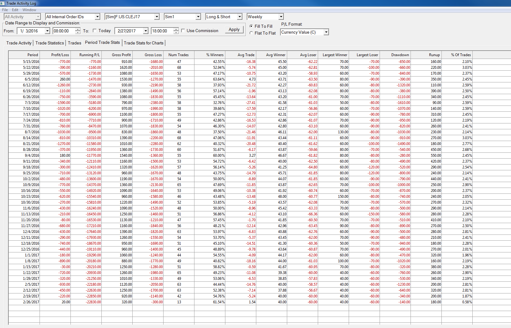

I just got done with a longer backtest and I've noticed that the price improvement discussed above stopped occurring starting the week of 01/22/2017. Please see attached screenshot of weekly trading results in particular the largest winner and largest loser columns. This backtest was 4 tick profit and 6 tick loser for CL so max profit should be $40. If you reference the screenshot, every other week had largest winners in excess of $40 (which shouldn't happen with limit order take profits) but the last 6 weeks functioned as one would expect. I thought this may be helpful in your analysis of my issue. Thank you.
imagebacktest.PNG / V - Attached On 2017-03-02 18:10:13 UTC - Size: 159.51 KB - 468 views

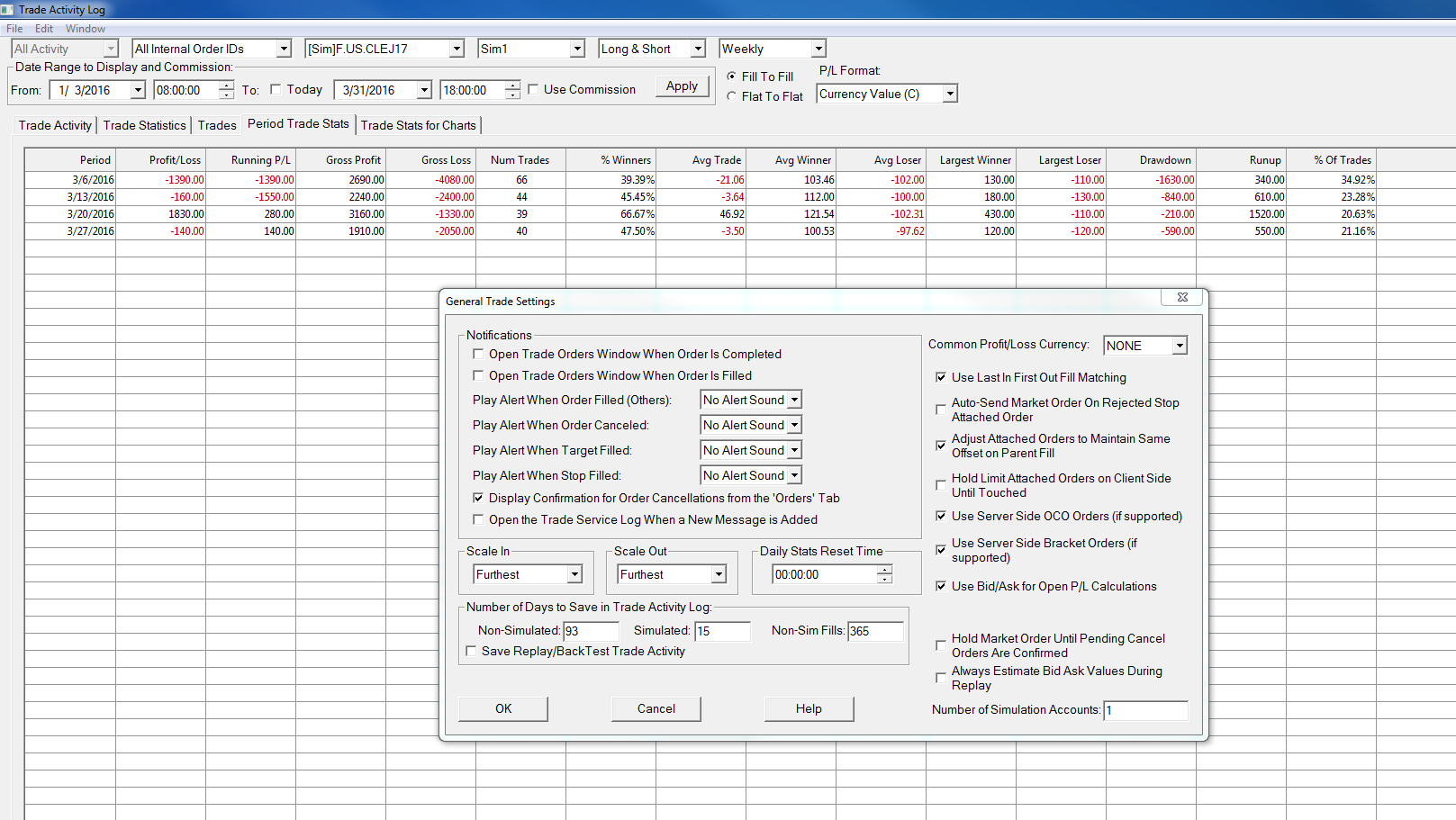

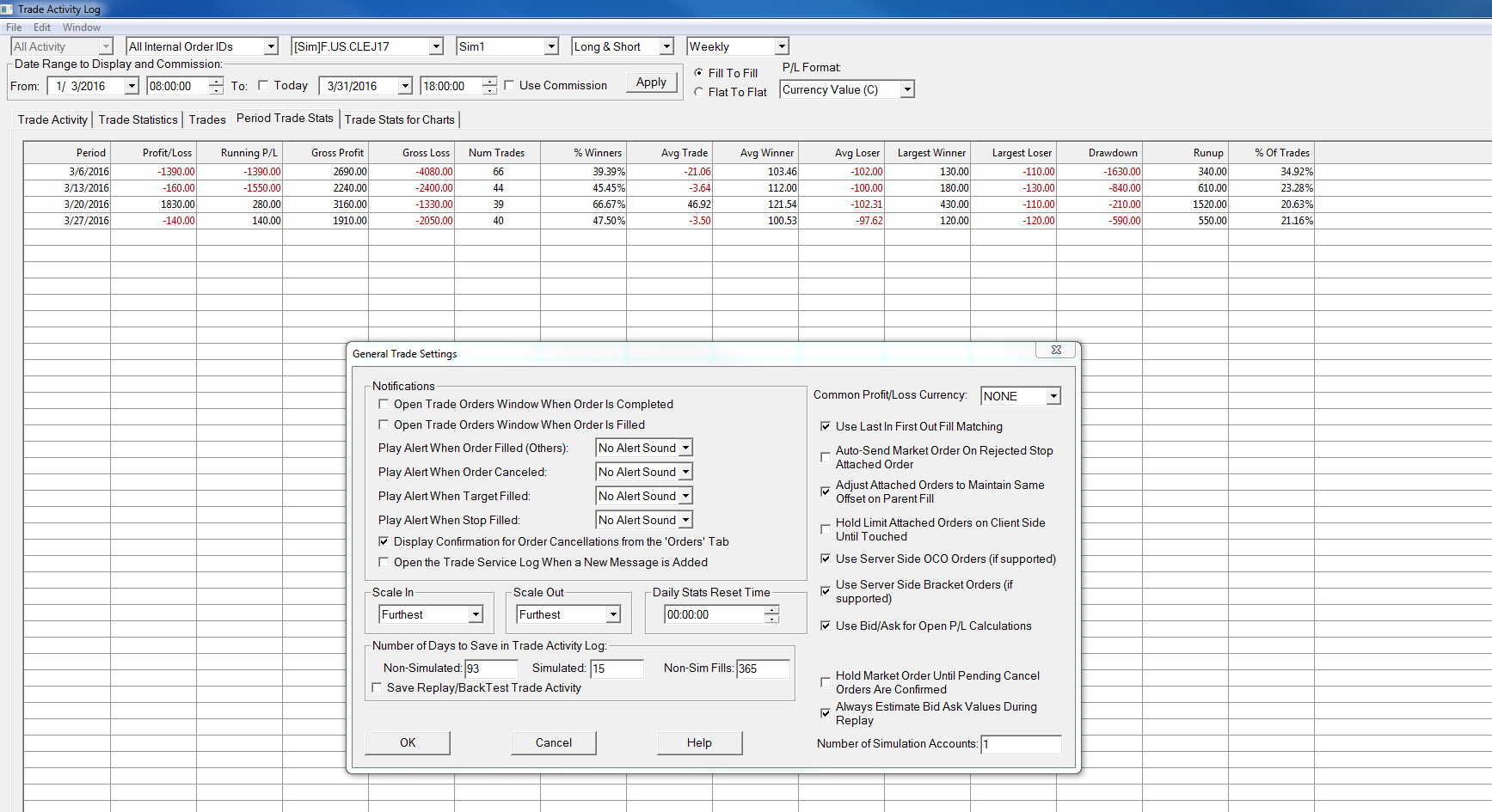

[2017-03-06 16:42:13]
User794640 - Posts: 33
Thanks for getting this pushed out in the pre-release. I had a chance to test it and I'm coming up with the same fills and same price improvement on limit orders regardless if I select the estimate bid/ask on replay or leave it unchecked. Please see attached screenshots.
I tried deleting and re-downloading data as well and it didn't help. Maybe there is another setting that I'm not applying correctly. Thanks in advance.
imagesim bad ask.PNG / V - Attached On 2017-03-06 16:41:38 UTC - Size: 131.39 KB - 489 views
imagenon simulated.PNG / V - Attached On 2017-03-06 16:41:43 UTC - Size: 129.99 KB - 569 views
[2017-03-06 19:22:49]
We verified that the Bid and Ask prices are now estimated when that option is enabled.
You can see these estimated values with each order fill.
An example of this is shown in this section here:
http://www.sierrachart.com/index.php?page=doc/TradeSimulation.php#HowOrdersAreFilled
They should be within one tick of the last trade price. If there is a problem we need to actually see the order fill line from the Trade Activity Log.
