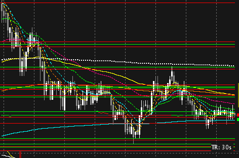

[2021-07-27 16:57:22]
GravisHTG - Posts: 321
Like this, It copies every single line no matter if it was removed by a price hit on the main chart.
imagecopy line extended.PNG / V - Attached On 2021-07-27 16:57:04 UTC - Size: 14.21 KB - 670 views
[2021-07-27 17:04:02]
John - SC Support - Posts: 48459

[2021-07-27 18:17:00]
The reason why the Extended Lines are not stopping is because most of them start (and end) well before the dates that are being displayed in the 1 minute chart. The 1 minute chart is only showing 11 days of data, whereas the Daily chart has 731 days. Therefore, the end date for those extension lines does not exist in the 1 minute chart so they are not stopped. If you set the two charts to have the same number of days, then they would show properly.
On an aside, the lines for the Swing High/Low are not showing in the Overlay Chart since the Subgraphs are set to Ignore. To display them in the 1 minute chart you would need to change the Input for Use Styles and Widths from Source Study to No, then change the Subgraph style to a Line.
