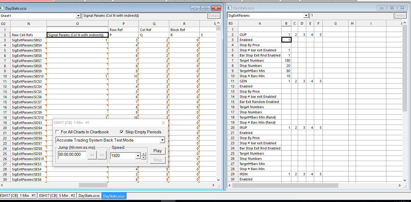

There seems to be a Problem with the spreadsheet subgraphs updating values sourced from cells on a seperate sheet that are manually inputted/ changed via typing Value into the referenced cell:
Using 2 spreadsheets - Sheet1 with subgraph outputs, the other is a blank sheet were user defined values are entered. It is Meant To be a Parameter array for an ACSIL study like sc.Input.
The subgraph sheet has an addressing formula To Order The user defined values on the blank sheet correctly:
=Indirect(Address(P3+8*R3+R3,Q3,1,1,"SigExitParams")) - In the photo(if it is needed) I included an additional column with indirect() removed so you can see that the cell references are correct and ordered Properly.
When I Change A user Defined Value on the blank Sheet "SigExitParams", and Recalculate the Chart - It is not always updating the Spread Sheet Subgraph with the new values.

imageSpread Sheet Views.PNG / V - Attached On 2017-02-26 07:15:25 UTC - Size: 88.55 KB - 372 views

I have included a chart book and spreadsheet file adhering to the outlined specs above.
Description Of Spreadsheet/ChartBook:
-There are a couple custom studies that are on my version. With the custom studies the only factor that may have an impact is sc.EarliestUpdateIndex is set to sc.ArraySize-50 in one of the studies when !sc.IsFullRecalculation.
-There Are 2 sheets int the spreadsheet study "DayStats" to concern yourself with:
1. SigExitParams: sheet that is not for Chart Data input, and is not an output. It simply is a place to enter settings.
2. Sheet1: -Subgraph Columns N-R are the columns to concern yourself with.
-Column O is the only column used for Output and contains ordered Cell Refs to "SigExitParams" sheet.
-the rest are helper columns That are used to Help O get the correct Cell Ref to sheet "SigExitParams".
Steps to Duplicate Problem:
1. Open The Chart Book.
2. Compare the Values in 'Sheet1' O3:O10 to the Values in 'SigExitParams' B3:B10. They will Identical in descending Order.
3. Change one or some of the cell values in 'SigExitParams' B3:B10.
4. Go to the Chart and Hit Recalculate.
5. Repeat step 2 - The Values in both arrays are supposed to remain Identicel but 'Sheet1' O3:O10 is not reflecting the new values.

[2017-03-01 23:22:53]
We have reproduced the problem and resolved it. We will have a new release out either today or tomorrow.
