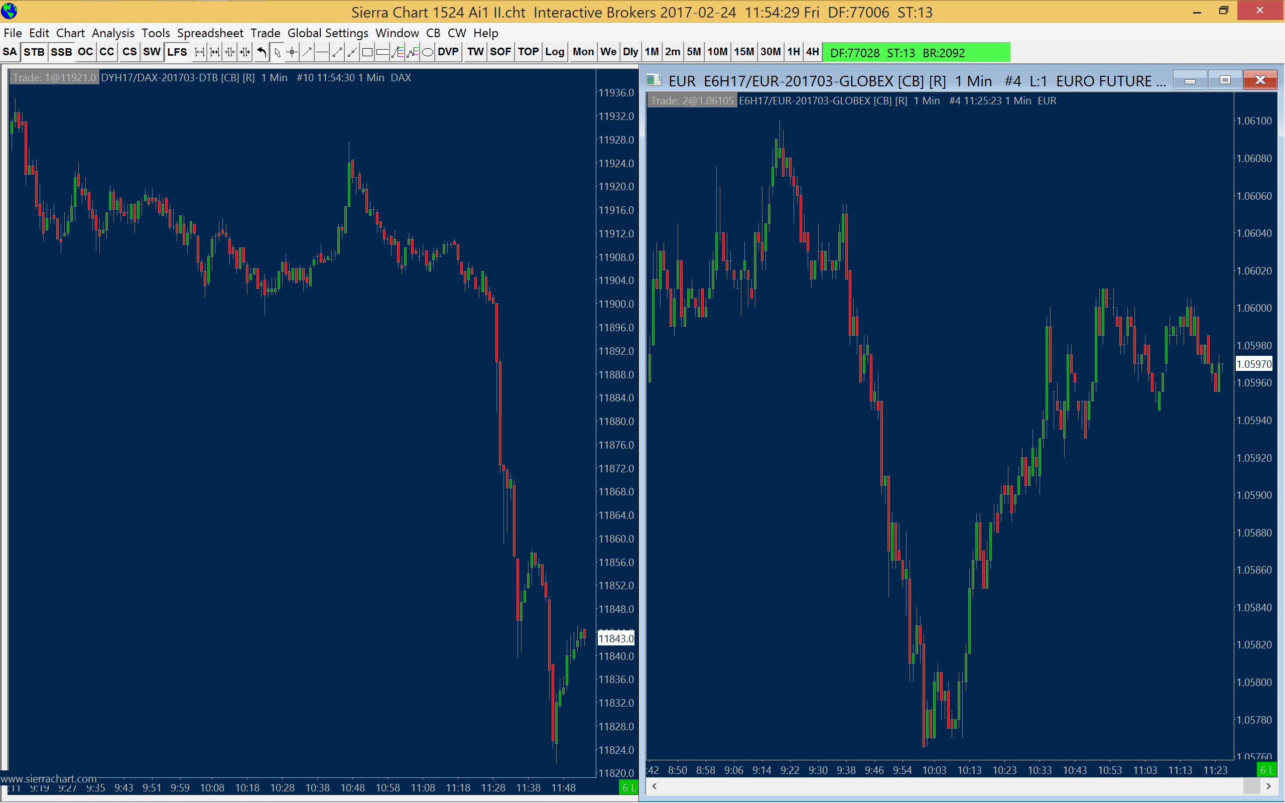

[2017-02-24 10:55:46]
User83654 - Posts: 5
It is working with Eurex data now. I am not getting live CME-GLOBEX data.
http://www.sierrachart.com/image.php?Image=1487933675631.png
[2017-02-24 11:12:45]
We are not understanding the reason for the symbol configuration that you are using and why you are using remote chart data files.
Since you are connected to Interactive Brokers follow the instructions here:
https://www.sierrachart.com/index.php?page=doc/SierraChartRealTimeFuturesStockDataFeed.php#IntegrationWithTradingServices
You should not be using remote chart data files. This is going to make it more difficult for us to help you.

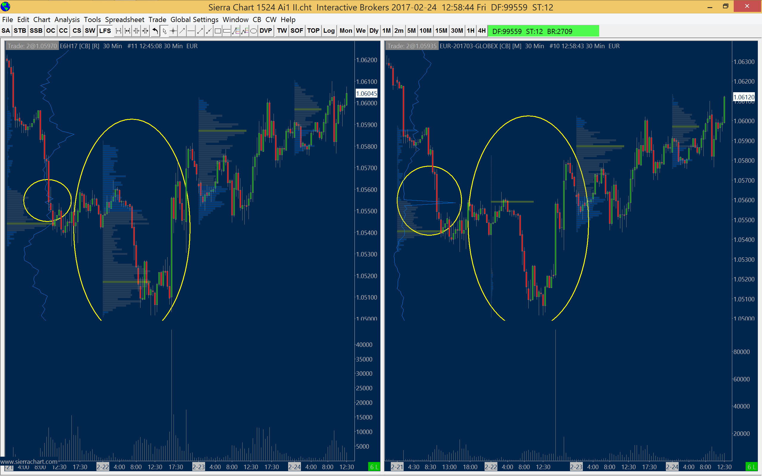

[2017-02-24 12:02:23]
The reason is that I am getting different horizontal volume data for remote and mapped data files - if compared it looks that for M it is corrupted.
http://www.sierrachart.com/image.php?Image=1487937528847.png
[2017-02-24 17:50:58]
Using remote chart data files is not the proper method to receive data from the Sierra Chart Exchange Data Feed. There is no reason to use this method. It is no longer considered supported.
What we want you to do for the chart on the right side, is to select that chart and then re-download the data by selecting Edit >>Delete All Data and Download.
This will ensure the data is correct.
If you want to share data between instances of Sierra Chart, then refer to:
Using DTC Server for Data and Trading in Another Sierra Chart Instance: Using DTC Server for Data and Trading in Another Sierra Chart Instance
