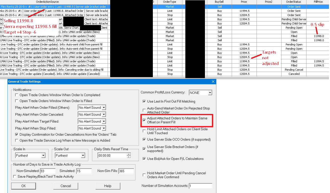

[2017-02-22 10:40:50]
gomifromparis - Posts: 244
I use LMAX DTC and the stop/targets are not ajusted with the fill.
imagelmaxadjust.png / V - Attached On 2017-02-22 10:39:59 UTC - Size: 58.5 KB - 374 views

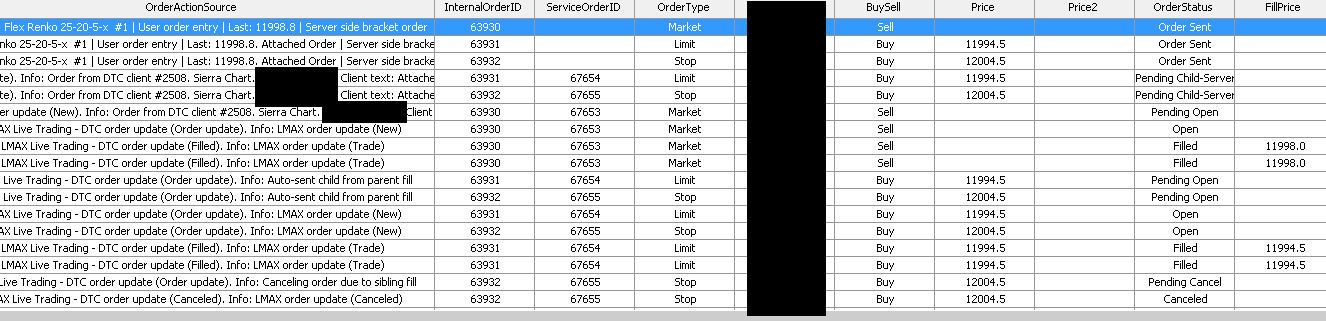

We need the Internal Order ID number of the parent order. Could you provide that.
We will also do testing on the demo system. We would not expect a problem with this. So we will have to look into it.
Date Time Of Last Edit: 2017-02-22 17:51:05
[2017-02-22 18:02:32]
Sure, 63930
Children 63931 63932
[2017-02-22 18:56:41]
Actually we realize that we need the Service Order ID.
[2017-02-22 19:25:59]
here's what I got
imagelmax2.png / V - Attached On 2017-02-22 19:25:39 UTC - Size: 30.44 KB - 369 views
[2017-02-23 04:19:41]
We do see the problem. We are looking into why the adjustment is not occurring.
Date Time Of Last Edit: 2017-02-23 04:19:53
[2017-02-23 05:15:09]
We now realize the reason for the problem. There is nothing wrong.
The adjustment does not occur with a market order because there is no reference price given with the market order.
We are testing a solution to this but it is only going to be released into the demo system for a couple of weeks before it goes live.
