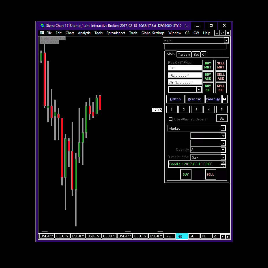

previous to current version (1445), i was using an instance of sierra in its own folder purely for entering trades to IB. i had the trade window visible on each chart in a chartbook. i reduced the size of the entire program window just to make the trading buttons visible only, and not the actual chart itself, which were running from a different broker from a different instance. when i upgraded to 1518, the chart becomes corrupted when the sc main window becomes smaller than a certain dimension

here is the window being shrunk right before it gets corrupted,

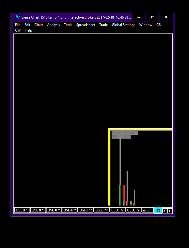

all i did was drag the corner a few pixels to reduce the size,

if i double-click the yellow line in the 2nd pic, the chart restores inside the window until i make the window smaller again. basically there's not a way to make the entire window shrunk down to where only the trade buttons and bottom chart tabs are showing, like in 1445

In this screenshot clearly we do not see a title bar:
https://www.sierrachart.com/Download.php?Folder=SupportBoard&download=10877
Why is that? So you are saying the operating system has removed it on its own?

they are not showing in the screenshot, correct, but i have them enabled
my guess is, the chartbook got pulled through several sc versions over time and got corrupted
i recreated a new chartbook from scratch and all is well . .
