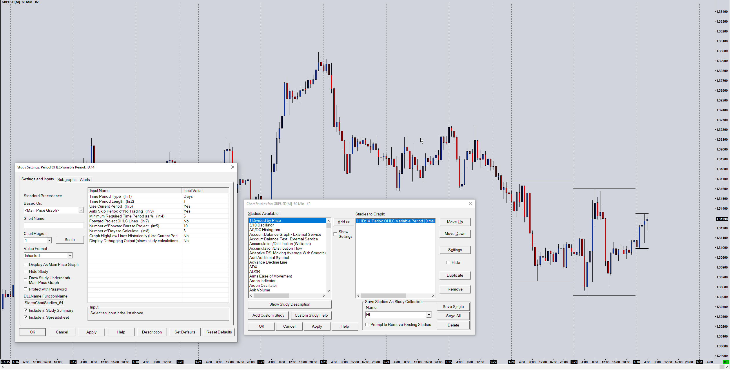

Hi, I am using this study but can't figure out if there is a way to not display the High and Low of the current day.
As you can see from the screenshot I visualize the H/L of the 3 days but what I would like is to see the 3 previous days and not 3 days from the current one.

[2022-03-30 11:58:14]
User438057 - Posts: 51
Try the study Daily OHLC
[2022-03-30 12:09:08]
User641398 - Posts: 19
I tried but it always starts from the first candle
[2022-03-30 12:25:04]
Look at the setting -Referece Days Back-
Under subgraphs use a negative value for displacement, this should do what you want, I hope
[2022-03-30 12:55:00]
Could you give me a screenshot because the negative value in the "reference Days Back" doesn't work for me.
Thanks for your help
[2022-03-30 15:36:26]
Set "reference Days Back" to 1, that means you ignore the last one day(the current).
A negative value you can set for displacement to have the drawings displaced more to the left side.
Just have a look to the description of the study.
[2022-03-30 16:48:03]
Okay I got it.

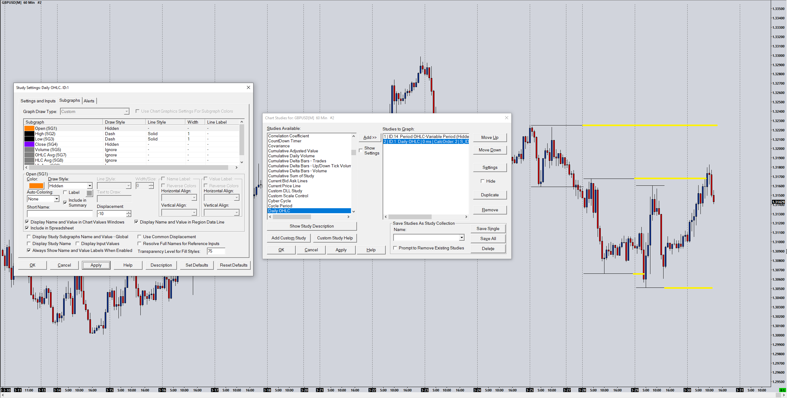

Is it possible to take these lines to the candle that crosses them? I'll put an example to explain better.
I drew the yellow lines
image2022-03-30 18_44_33-Window.png / V - Attached On 2022-03-30 16:47:56 UTC - Size: 172.08 KB - 292 views
[2022-03-31 15:52:18]
This probably is going to require custom ACSIL programming. Refer to:
ACSIL Interface Members - Functions: sc.AddLineUntilFutureIntersectionEx()
