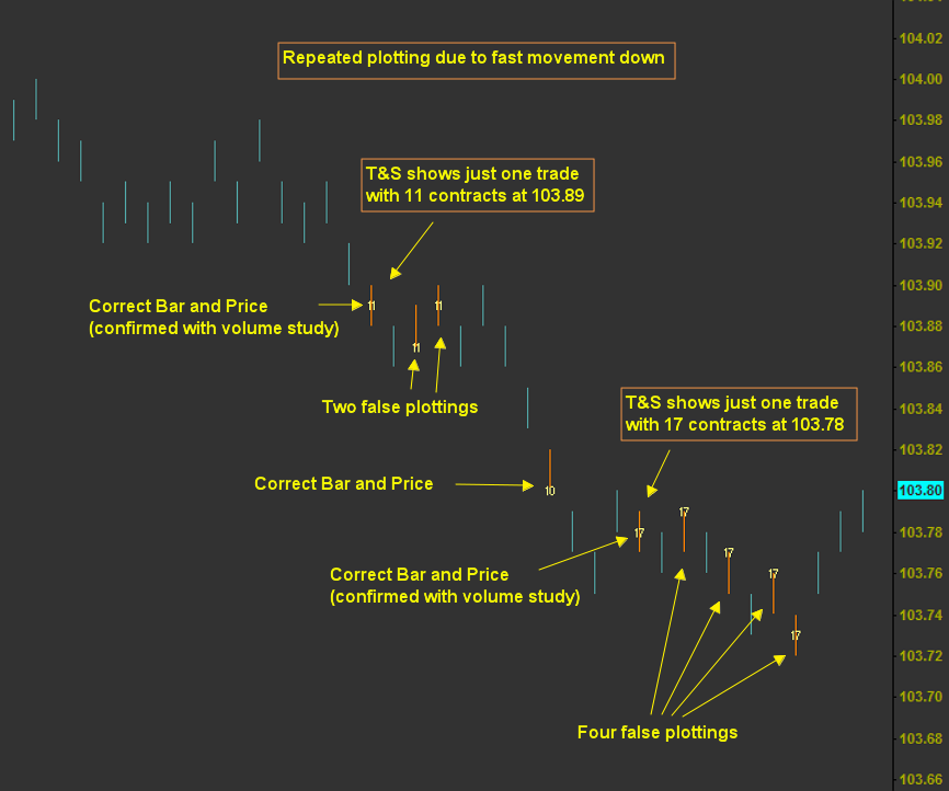

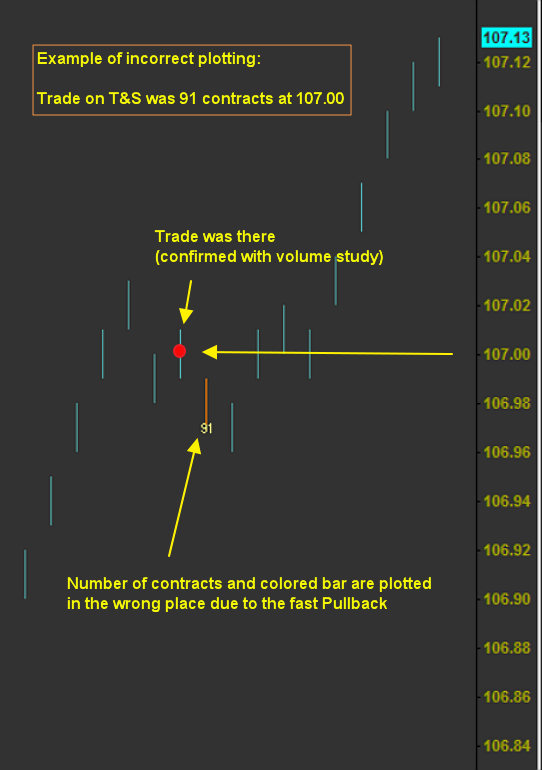

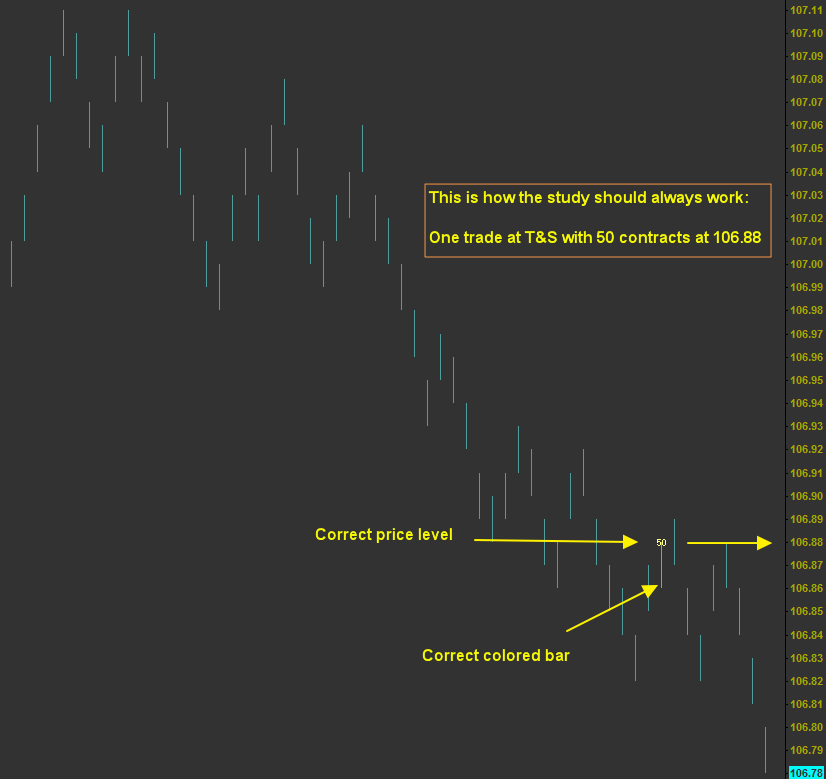

The purpose of this study is to “capture” from the time & sales every trade with volume above a certain threshold (user defined). The study then plots the number of contracts of every of those trades at the respective price level over the chart bar where the trade occurred, and at the same time, signal that same bar (coloring).
I have this study installed on a 2 Range chart with Crude Oil futures, an instrument which price can sometimes move very fast.
The study works well when the price movements are slow; the problem is when the price is moving faster and / or with thrusts. When this happens – very often – and the chart bars are plotting fast, the study may plot the number of contracts of a trade in a wrong price level, may color the wrong bar, may plot the number of contracts in a different bar or even color the bar and plot the number of contracts repeatedly in two, three, four different subsequent bars instead of one.
It is not a problem related to the data feed as it happens with both IQFeed and IB data feed. Actually this problem is even worse with IQFeed because the chart plotting is faster and plots more bars.
I don’t know anything about programming; but I would risk to say it seems to me that when the price and chart plotting are moving fast, the time the study takes to “capture” a trade and plot it in the chart suffers from some delay, causing it to plot too late and so in the wrong place or sometimes repeatedly, as the price in the chart has already moved away from the place where the trade happened.
As one image can say much more than many words please see the screenshots attached with some examples.
