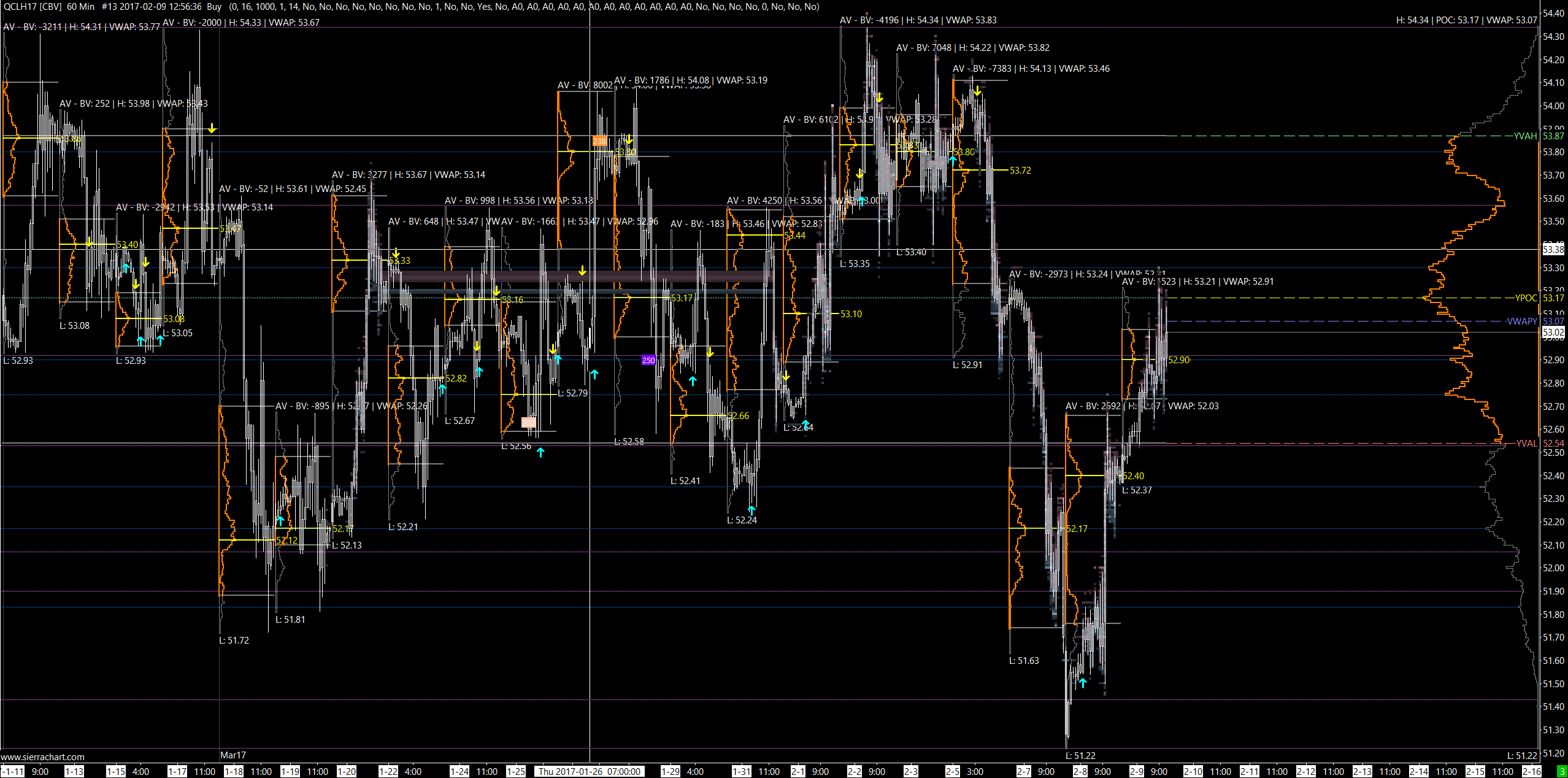

sorry i am new at this.. basically i was combining what i have read and trying to make it work.. sorry the formula did not make sense.
basically i was trying to automate the study MACD CROSSOVER SYSTEM to make it an automated strategy,
whereby it buys at the blue arrow and sells at the yellow arrow.. see image attached
http://www.sierrachart.com/image.php?Image=1486663003767.png
