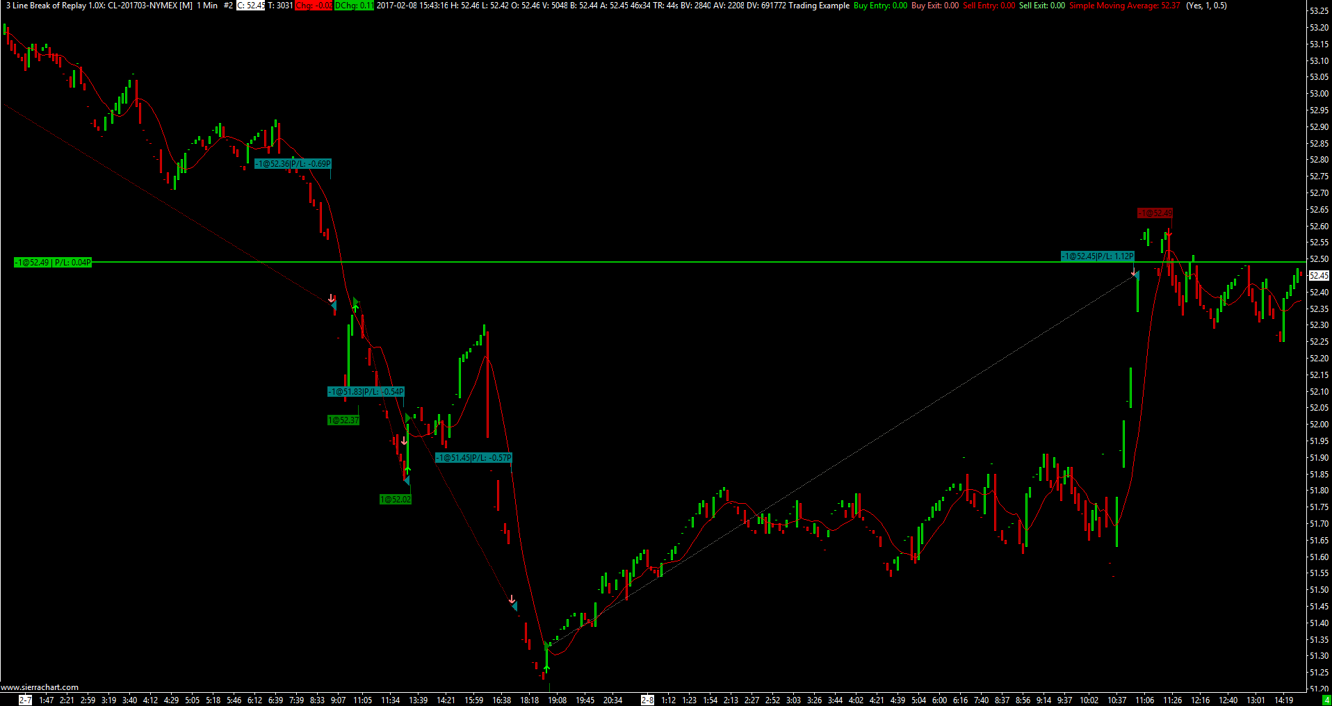

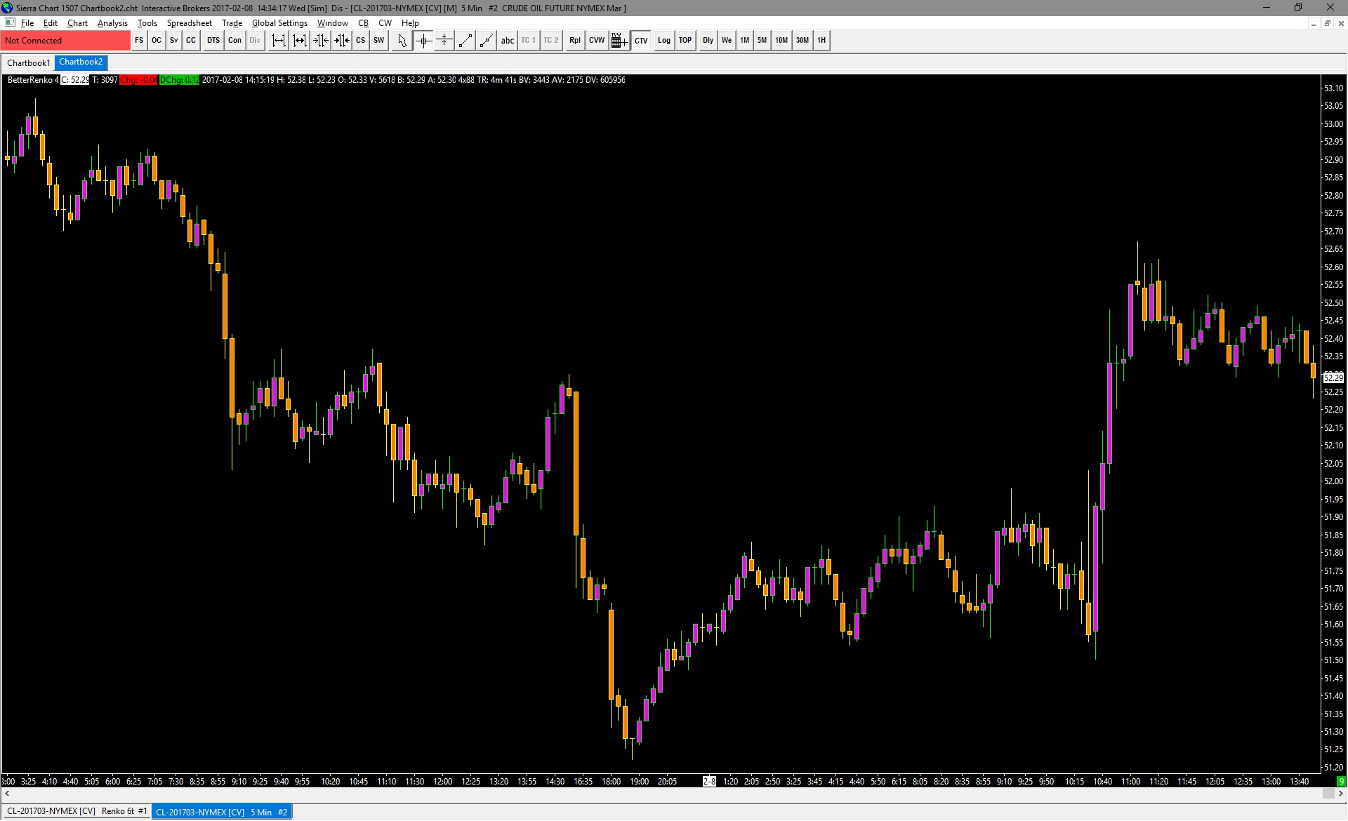

Thank you for your prompt response. Perhaps I haven't stated my question clear enough. Attached please find two pictures of a 5-min crude oil (CL) chart:
1. The first one has only the BetterRenko study applied, with all input parameters being the default except that "Show real open" was set to "Yes". There is no problem in this picture.
2. The second one has the BetterRenko and the "Trading Example" (TargetValue=0.3; Stop Value = 0.1) studies applied. The image was captured right after a Bar-Based BackTest.
As shown in the second picture, the chart was somehow "corrupted" and the entries and exits of trades are clearly not correct.
Since both studies are bundled with SC, I guess you might be able to reproduce the result.
Apart from BetterRenko, the 3-line break study exhibits similar behaviors as well.
Hope this would better describe my question. Any hints would be highly appreciated. Thank you.

Better Renko is a user contributed study and we provide absolutely no help with it. We are removing it from the list of User Contributed studies. Do not use it.

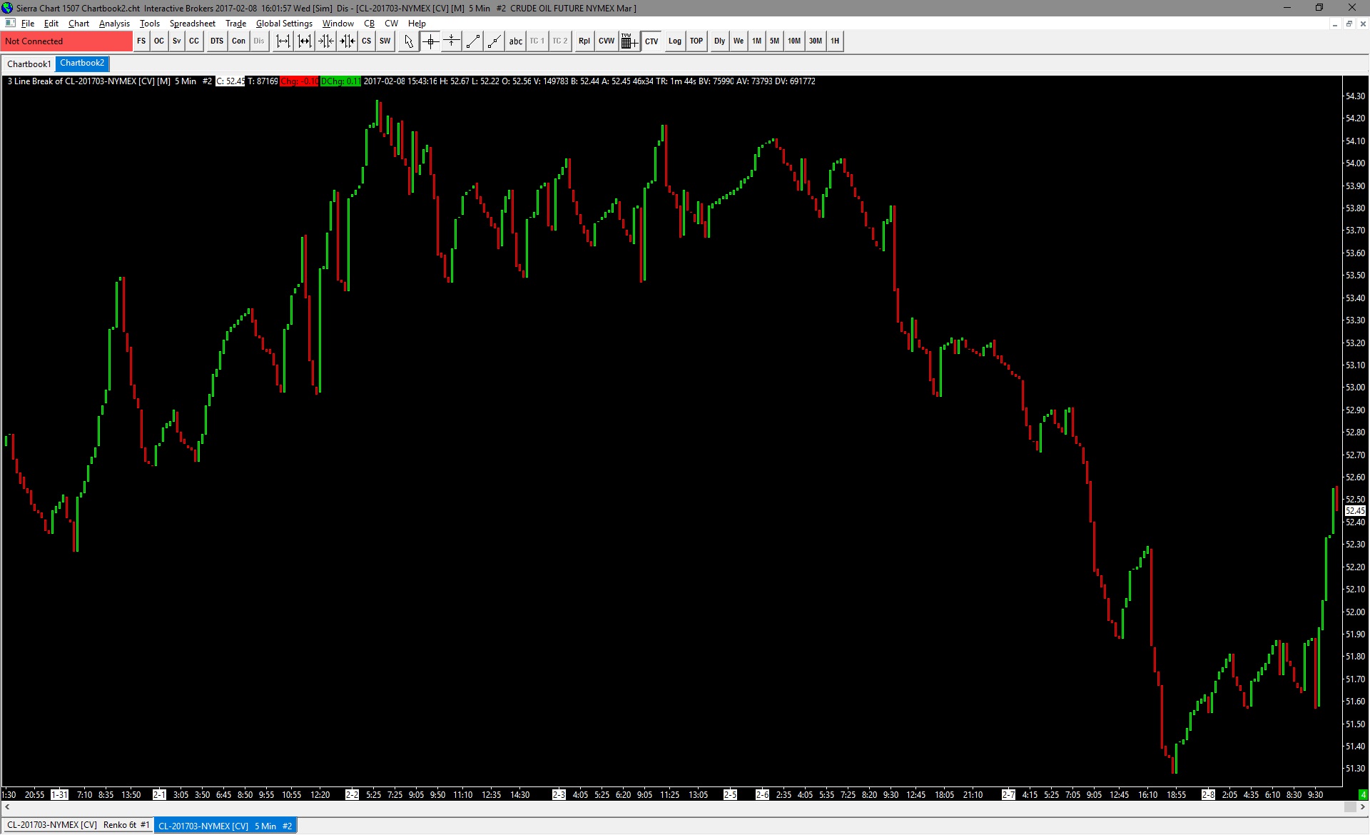

Yes, I am using that "standard" 3-line break study, and as you have mentioned, it does function correctly in a replay backtest. However, if a bar-based backtest is performed, the same occured - the chart was "corrupted" and the entries and exits of trades are not correct. Please see the attached pictures.
Could that be fixed (or have I overlooked anything)? The bar-based backtest is far more convenient than replay for system prototyping.
On a side note, BetterRenko IMHO is a useful study. I suggest keeping it (no matter it can be back-tested correctly or not) unless there is a similar alternative. Thanks for your consideration!

Thanks for your help. Here are what I did - I start from scratch here and am repeating the steps while typing this message:
1. Open a new intraday chart ("CL-201703-NYMEX"). In the Chart Settings, set "Days to load" to 10, and "Graph Draw Type" to Candlestick Bars.
2. Enable Trade->Show Order Fills.
3. Add the "Three Line Break Chart" study, and set "Show Real Open" to "Yes". This would lead to the following clean chart:
http://www.sierrachart.com/image.php?Image=1486591617543.png
4. Add the "Trading Example" study, set "Enabled" to yes, "Target Value" to 1 and "Stop Value" to 0.5.
5. Perform Trade->"AutoTrade System Bar Based BackTest". The following chart is resulted:
http://www.sierrachart.com/image.php?Image=1486592190696.png
6. Now, I perform Trade->"AutoTrade System Replay BackTest" (which took much longer), everything becomes normal again:
http://www.sierrachart.com/image.php?Image=1486592600502.png
Not sure why this happened. Thanks again.
[2017-02-09 17:46:09]
We do see the problem now following these instructions. We will be looking into this, but it is quite involved and we do not expect to get to it for many months.
You need to use a replay back test and not a bar based back test.
