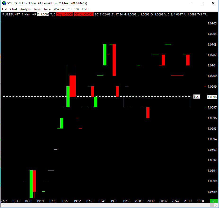

[2017-02-08 03:24:03]
User360283 - Posts: 538
On a 1 minute candlestick chart, studies are Current Price display Bid and Ask lines
Trades are showing on the DOM in the 5th digit, but bars are not painting until the 4th digit changes.
This makes the price "jumpy" and bars are not shown.
A TDAM 1 minute chart plots to the 5th digit and does not have this missing bar problem.
Note the "missing" bars on the screen shot encl.
imagesierra 1 min.PNG / V - Attached On 2017-02-08 03:22:48 UTC - Size: 24.68 KB - 492 views
[2017-02-08 03:49:54]
None of this is making any sense to us. That particular symbol only trades to .0001. That is definitive and verified. This is a matter of fact and we cannot provide any help on this point further. If you see trading beyond the fourth decimal place, the data is *faulty* or there may be an incorrect multiplier setting.
At the time you notice a difference between the Trade DOM and chart, post an image of both following the instructions here:
Be sure to follow these instructions and use no other method.
Go to the Trade DOM and chart and set the Chart >> Chart Settings >> Price Display Format to .00001 so we can see to five decimal places.

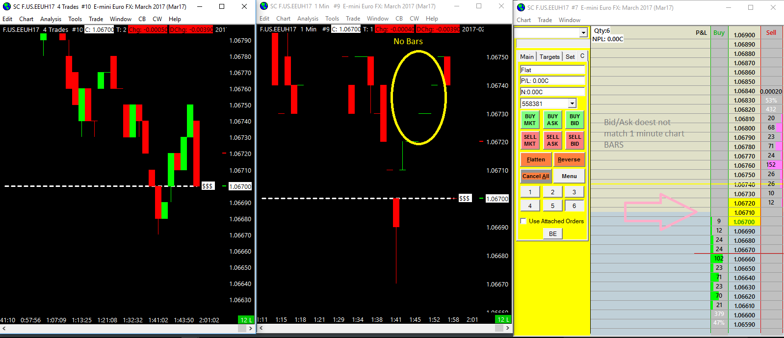

[2017-02-08 08:19:12]
I have placed 4 Tick and 1 Minute charts next to the DOM.
See encl screen shot.
Note that the 1 minute chat is missing bars while the Tick chart has the bars.
The DOM shows Bid at 1.06700 and Ask at 1.06720 and on the 1 minute chart the Bid Ask lines correlate but there is No matching bar. The last bar painted on the 1 minute chart ends at 1.06740. This is the visual error. Note the Tick chart does not have this error as the last bar bottom matches the Bid at 1.06700
So far, it seems the problem is with chart types other than Tick. I have tried Volume, and Renko and experienced the same problem.
I hope this is clear
imagesierra 1 min.PNG / V - Attached On 2017-02-08 08:13:24 UTC - Size: 90.19 KB - 506 views

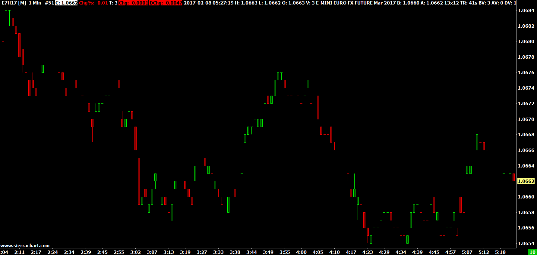

[2017-02-08 10:30:22]
Here is a one minute chart for that symbol using the New York Time Zone:
http://www.sierrachart.com/image.php?Image=1486549666274.png
Your chart looks fine. There is nothing wrong. This case is considered closed. We cannot provide further help. You believe there is a problem when there simply is not.
