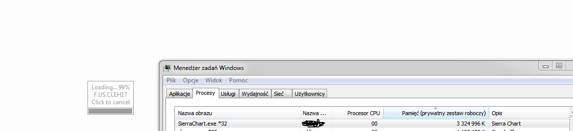

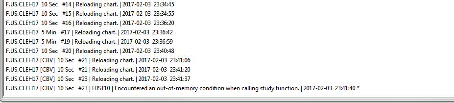

Same problem here. I've noticed strange behaviour of 1510 release. Memory peeks over 3GB, CPU is ca. 12% almost all the time. I get unhandled exception errors, and Sierra freezes when trying to recalculate chart. See screens attached. None of that problems on previous releases.
My system: 16GB RAM, i7 CPU

The first thing we want you to do is to refer to help topic 17 if you are using custom studies:
Sierra Chart Unexpectedly Shutting Down | Memory Errors | Unusual Software Problems | Exception Errors | Freezing of User Interface
