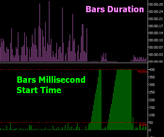

[2013-08-09 12:49:52]
Hendrixon - Posts: 130
SC version 1007.
1. No bar has a start timestamp of over HH:MM:SS.400 (400ms)
2. Bars always have a start time which is very close to the "seconds" (__:__:SS.000) start.
examples:
Crude Oil 50 Volume bars = Bars start time is always less than HH:MM:SS.50 (50ms).
Crude Oil 100 Volume bars = Bars start time is always less than HH:MM:SS.85 (85ms).
There are two exceptions to #2:
A. Either the bar's own duration is 1 second or less.
B. Or the prior bar's duration is less than 1 second.

[2013-08-09 17:39:00]
We do know about the 400 milliseconds. Implementing millisecond support properly does take a lot of considerations and various small changes in many areas of Sierra Chart which have not been done yet. All has to be considered carefully. We had to limit this to 400 milliseconds to avoid getting close to 500 milliseconds or over which can cause problems with how time values are rounded now.
[2013-08-10 14:30:14]
Understood.
Any time frame when to expect the 400ms limit off?
What about issue number two?
It can't be that only bars with a duration of 1 second or less, have millisecond timestamps that are bigger than 50ms or 100ms? you obviously do something there as well.

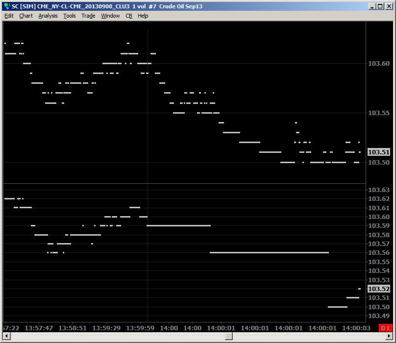

TastyRisk - Posts: 119
I would like to see real millisecond support.
IMHO; SC is losing value as the market becomes more efficient.
If we can't get accurate bars then what's the use of the software?
I'm spending more and more time with open office nowadays as "no charts" are better than "inaccurate charts".
imageMILI.png / V - Attached On 2013-08-15 13:32:23 UTC - Size: 18.77 KB - 780 views
