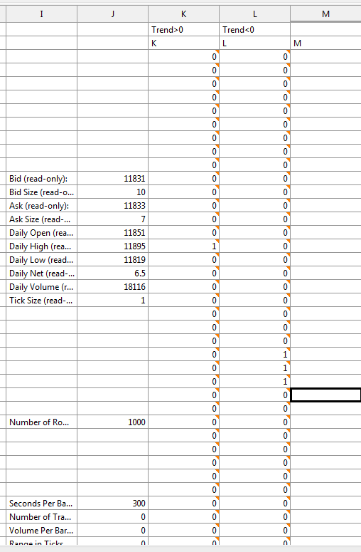

I am Defining the start of a new trend when there is a close above the Prior Bollinger Band on Column K With IF (blabla,1,0).
On the second Column L I define the start of a downtrend when there is a close below the lower Bollinger band with IF (blabla, 1,0).
So Column K will be full of Zeros and at some point it will print 1,then Zero again. The same with Column L.
What I want to define in another column is when the K column printed the first 1 to track the L Column until it prints 1. Any Ideas how can I define this with Logical functions.
I am giving a screenshot for reference.
Thank you in Advance

[2017-01-26 18:07:08]
First, it is not necessary to use the IF function.
You can just use a formula like: = ID0.SG4@3 > ID3.SG1@3
Did you want to know the time this happens?:
Sounds like you want to use the GetCorrespondingMatch function:
http://www.sierrachart.com/index.php?page=doc/SpreadsheetFunctions.html#GetCorrespondingMatch_Function

[2017-01-26 18:25:56]
JRA - Posts: 97
I will Give it try.
Actually What I want to finally do is track the lower line when there is a close above the upper BB, and when there is a close below the lower BB track only the upper line. I like it because I force myself to trade with the trend and keeps my chart clean.
