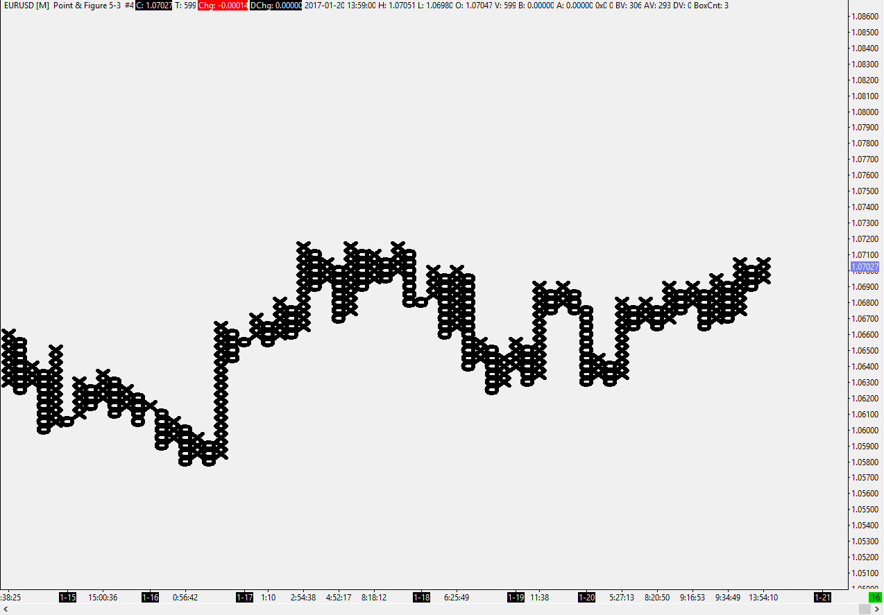

User15414 - Posts: 20
I have removed all studies and am only using the bar period type point and figure with graph draw type point and figure and I have a 5-3 in the chart settings but I am getting single box reversals. My tick size in chart settings is .0001 for the eurusd.
Date Time Of Last Edit: 2017-01-22 21:44:24
image2017-01-22_13-38-59.png / V - Attached On 2017-01-22 21:44:09 UTC - Size: 39.17 KB - 377 views
[2017-01-22 22:28:37]
Uncheck Chart >> Chart Settings >>New Bar at Session Start.
