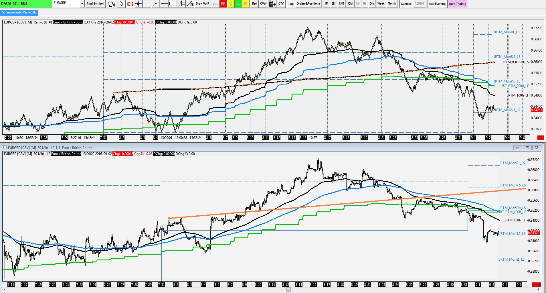

Sporken - Posts: 82
Thanks for your help earlier. It worked!
I've attached a pic in case you're curious what it looks like. The top chart shows the renko projection of the ray (in orange and black) and the bottom chart shows the original Ray on a 60min chart. The study is actually added to a 3rd offscreen 5min chart to make sure it gets good resolution. I do the projection there and then let the study/price overlay project the 5min subgraph onto the renko chart. Each orange/black segment is 5 mins.
Thanks again for you help
-Jason
imageOrange and black line projection.jpg / V - Attached On 2017-01-15 19:58:50 UTC - Size: 975.58 KB - 587 views
