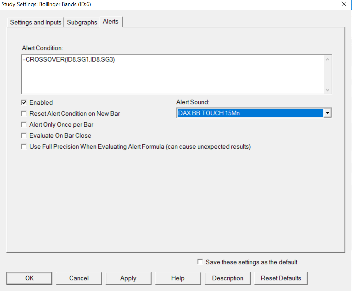

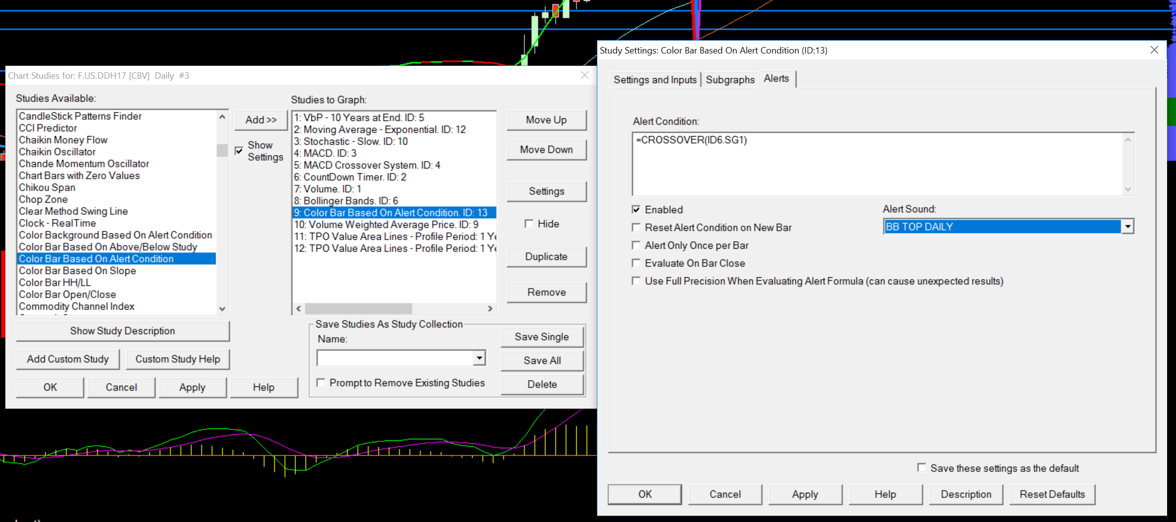

I have tried to implement in a 15mn chart a specific alert when a candle cross a Bollinger Band, a Bb Top and/or a BB bottom adding 2 studies 'Color based on Alert Condition'
and this code on each:
=CROSSOVER(ID8.SG1)
=CROSSOVER(ID8.SG3)
ID8 is the Bollinger Band indicator
SG1 is the Top Bollinger
SG3 is the bottom Bollinger
But this do noes trigger the custom sound.
On a daily chart, if I do implement this code: =CROSSOVER(ID6.SG1,ID6.SG3) directly on the indicator Bolling Band, then I cannot distinguish the Top to the Bottom Band cross.
ID6 is the Bollinger Band indicator
Please see attached files..
On the alert manager, I get a continuous message error telling me there is no sound file implemented.. and ARGS!
Does it mean that arguments are missing ?
Thanks for your kind help !

Here is the documentation for the CROSSOVER function:
http://www.sierrachart.com/index.php?page=doc/SpreadsheetFunctions.html#CROSSOVER_Function
