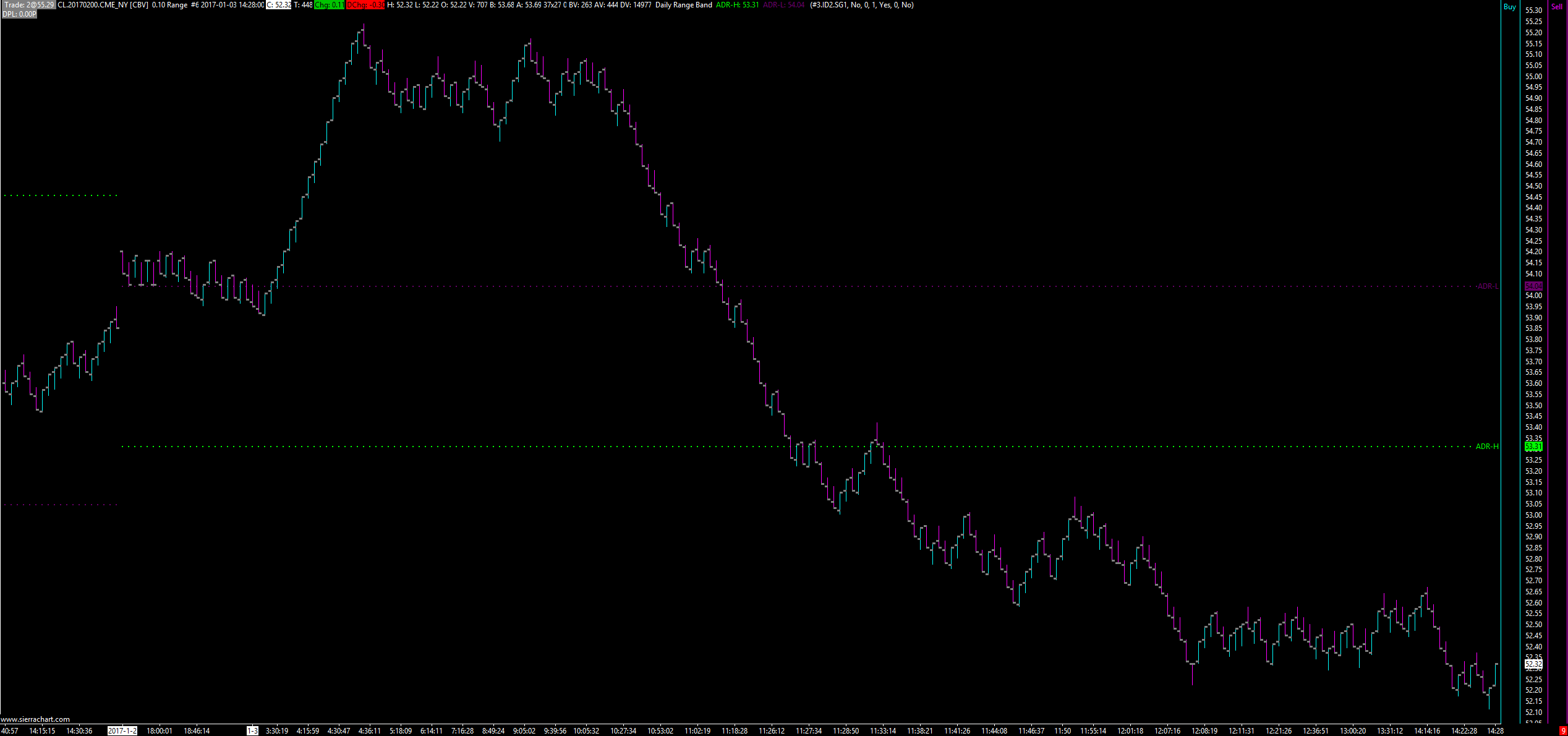

I've added the Daily Range Bands indicator to my intraday chart, referencing ATR on my daily chart. I'm not sure why on one of the days the upper and lower bands reversed?
Also, is there a way to set the bands to work off the previous day's close?
Thanks.

Ok, I believe I have followed your instructions correctly.
http://www.sierrachart.com/image.php?Image=1483947671245.png

We need time to look into this. Please allow about two weeks.
[2017-02-18 01:01:49]
We apologize for the long delay with this.
We have finally done testing and a code review and what you see is the correct mathematical result.
The documentation has been updated along with a described solution:
The output consists of two study Subgraphs that form the upper and lower bound of the predicted range using the days High and Low and the Range study referenced.
Upper Band when Gap Adjust With Yesterdays Close is No: (Low for day + Range Study Reference Subgraph for the corresponding day) * BandMultiplier.
Lower Band when Gap Adjust With Yesterdays Close is No: (High for day - Range Study Reference Subgraph for the corresponding day) * BandMultiplier.
Upper Band: (Minimum(Low for day, Previous day close) + Range Study Reference Subgraph for the corresponding day) * BandMultiplier.
Lower Band: (Maximum(High for day, Previous day close) - Range Study Reference Subgraph for the corresponding day) * BandMultiplier.
Reversed Bands: In the case where you notice that the Upper Band Subgraph is lower than the Lower Band Subgraph, you need to increase the Band Multiplier value to solve this.
Updated documentation:
https://www.sierrachart.com/index.php?page=doc/TechnicalStudiesReference.html#s349
