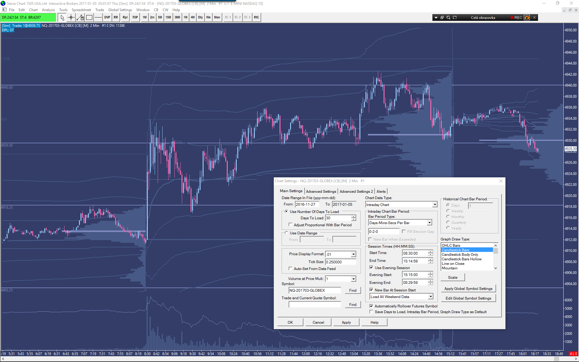

I'm using RTH and ETH settings for my chart. I would like to use the VwapBands indicator for RTH session but the settings doesn't support this. When I set "Use Chart Settings Time instead of 0:00" to "YES", it starts calculate the VwapBands indicator from ETH session. I really don't know why?
Another option is start to calculate from 0:00 obviously. But, it is not helpful. Unfortunately, there is no settings, how to set VwapBands indicator to calculate for RTH session (if you want to use RTH and ETH sessions together).
It would be better to add to settings a parameters "Start time" and "End Time". Could you make an update? Or give me an advice how to achieve my goal?
imagebandicam 2017-01-05 12-01-07-609.png / V - Attached On 2017-01-05 11:02:06 UTC - Size: 136.83 KB - 446 views

You are asking about a user contributed study.
In general this is not supported with studies.
You need to follow the instructions here for this:
http://www.sierrachart.com/index.php?page=doc/StudyPriceOverlayStudy.php#OverlayStudyDiffSessionTimes
No definitely not. This is not going to happen.
