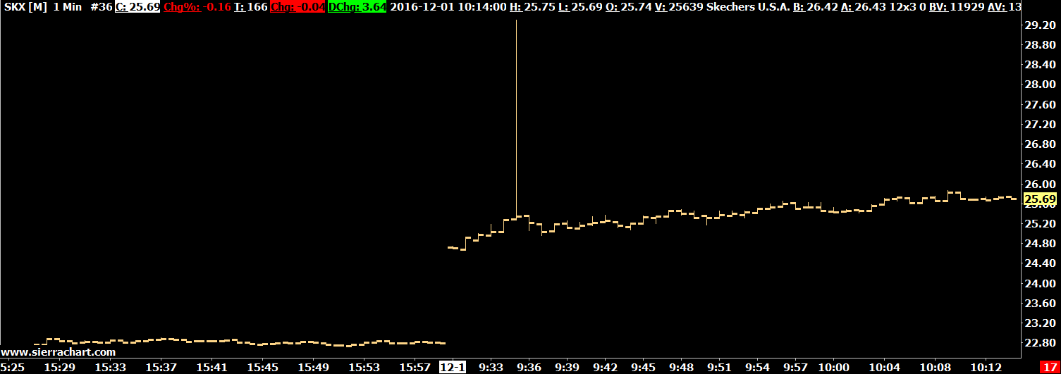

What is going on? I am paying for Sierra charts Data feed. I am seeing the data feed for charts is comming from IB. I have IB as my service. to trade from Sierra Charts. I wanted to only trade to IB not get their data feed. Cause its crap. SKX for example is giving me fake print @ 9:35AM going all the way to 29.20 this is obviously from IB and not Sierra charts. Like what you mentioned previously to me, I put a check mark beside Allow Support for Sierra Chart Data Feeds. Obviously this is not fixing the issue.

Do you see a [M] text indicator after the symbol at the top line of the chart?
If so the market data is coming from the Sierra Chart Exchange Data Feed.
We think we know what you are referring to:
http://www.sierrachart.com/image.php?Image=1480614914803.png
We need to examine this and find out if that trade should be removed from the chart. That was trade data transmitted by the exchange but it may have a special indicator on it which indicates it should be excluded. Although we generally have to be careful about this because we could end up excluding valid trades.
Just give us a couple of days to look into this.
