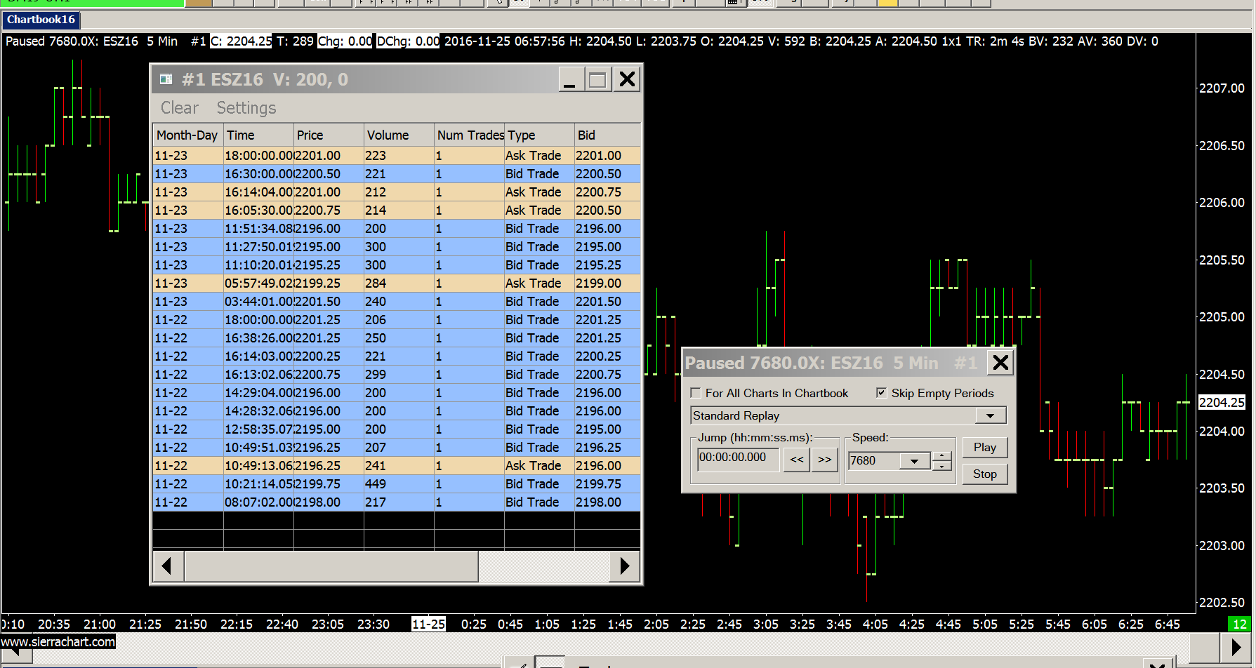

I found a bug: once replay chart is loaded and is more tha 480 speed time and sales windows IS NOT displaying data correctly.
Do you think you may fix it ? I am simulating the ES mini future.

Does not make sense why there would be a problem and we do not observe this problem. It works properly for us:
http://www.sierrachart.com/image.php?Image=14801166240.png

[2016-12-19 22:37:40]
FerroTrader - Posts: 72
hello,
here attached you can see the video in which I show you that the Chart Replay function works 100% correctly by printing on the T&S all the records it is supposed to print...
But one and only once the speed is increased, on the T&S window only some of the trades are printed.
Please, feel free to get in touch with me since I still think this is a bug while I am actually hoping I am wrong.
thank you for your time
Andrew
attachmentsc_TnS_possible_bug.7z - Attached On 2016-12-19 22:35:25 UTC - Size: 4.28 MB - 568 views
[2016-12-20 05:02:04]
We understand the reason for the problem. You are running high-speed replay which is freezing the user interface preventing the Time and Sales window from updating and therefore trades are being missed.
We have to think about this.
Unless you really have a need, we do not recommend calculating at every trade. That is is extremely CPU intensive. That was only added based on some user requests.
However, it is detrimental to use unless you have a very good reason to be using it. We really do not recommend it. And actually if you are using it, it really is not meant that you would be relying on anything visual like the Time and Sales window. Therefore, in a certain sense, this report is a non-issue. But we will see how to solve it.
